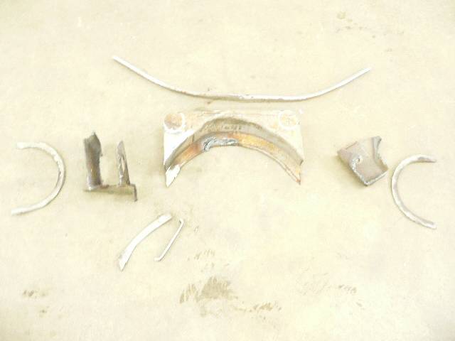

Motor plate in what to do about old mount brackets on k member. Do i leave them or cut them out.
Whap em. And while you're at it cut it for more oil pan clearance
Doug
If they’re not in the way and you think you might use them again in the future, leave them in. Otherwise cut em out
I did the cut for oil pan already. Dvw very clean work. I was going to cut them out then reinforce gear box mounting plate. But i see you didn't do yours so mine would be good without. Thank you on the pic
I left mine alone, cause I have the mounting brackets, and it's a real big block 62-65 k-member. And I might someday decide to put them back.

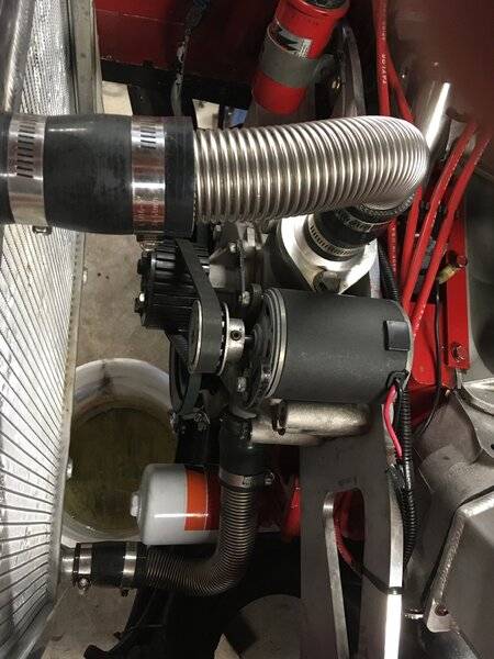

I've got a low mount aftermarket gm one-wire, hung under the ear on the pass side, driver side connection for the lower hose, hooked to a Cordoba big block high efficiency radiator.
Okay great i wondered about those. I'm also wondering about which water pump housing to use and on your frame rails i see you went to the top and side is this for extra strength.

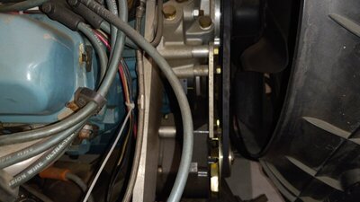

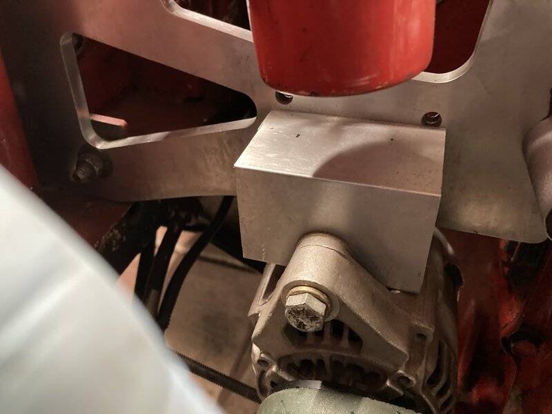

Don't know that the plate brackets really needed to be that fancy. But I liked the way they look. I like to fab stuff. Single stage urethane. Any pup housing will work. You can trim it the plate thickness if you want the pulley alignment to stay.
Doug

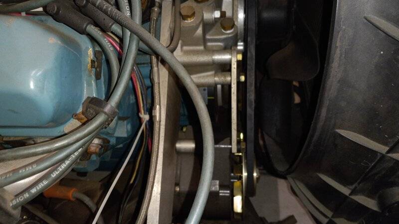

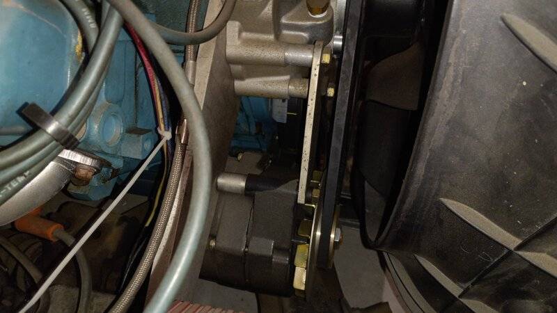

Here's mine. Flat plate off the housing bolts, spacers made to locate the alternator, through bolt into the elephant ear tapped hole, and an adjusting arm underneath, also off the pump housing. All home made.
