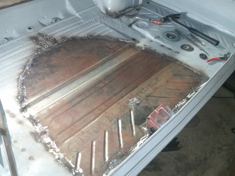

A whole lot of welding . . .
Holy cow . . . there is a whole lot of welding that needs to get done back here . . . and I'm on it . . . kinda hard to weld when the sweat is falling off your face . . .
But I'm working my way through it . . . and the work is coming along pretty well too . . . here's the rib and the translation from new metal to existing trunk metal . . .
And the driver side corner - with some of the initial grinding being done . . . lot more work . . . but jope to have this wrapped up this weekend . . .
Then onto the next project . . . I need to replace the cross member for the shocks - at the rear end - that I cut out of the car - want to replace it with a new fabrication that will allow me to move the upper shock mounting locations as I wish . . . working on a plan . . .

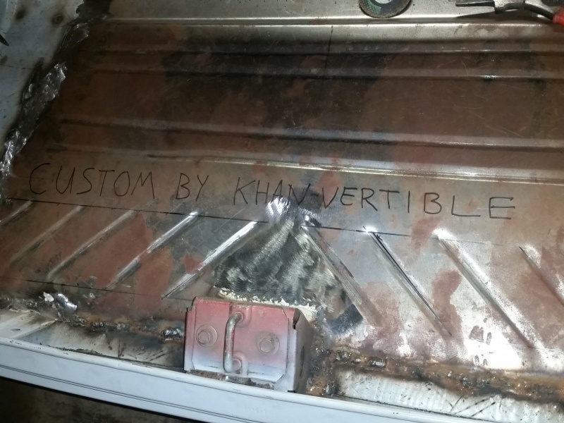

And you're so very right about the "ruh-roh" . . . this car may not be perfect . . . but I am working on it one step at a time . . . including all the mess ups that I have to correct
( a good fabricator can hide his mistakes . . . ok - I'll try - but I can't hide a bead that it permanently embedded in the trunk of my car for the world to see )

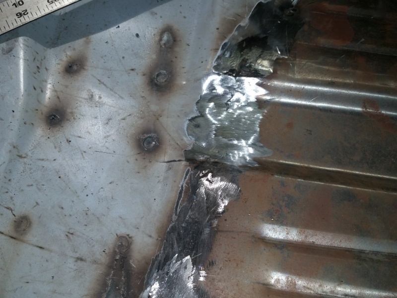

Fixing my ooooops . . . .
And who's bright idea was it to work on Welding when it's 90+ degrees outside ! ! ! . . . wait . . . that was me . . . ARGH ! ! !
Here's the little corner that was mis-cut . . . being corrected . . .

Got most of the welding done - need to go back over it and find the pin hole and get them fixed . . . and
Back to the MAG technology . . . MIG And Grind . . . ( repeat . . . over and over again . . . )
And . . . after all the welding and whole lotta grinding . . . I've got a "new" trunk in the Belvedere that now looks like this . . . .
Got some more cleaning up to do and the grinds, and get this into primer . . . and I'll have the trunk done . . .

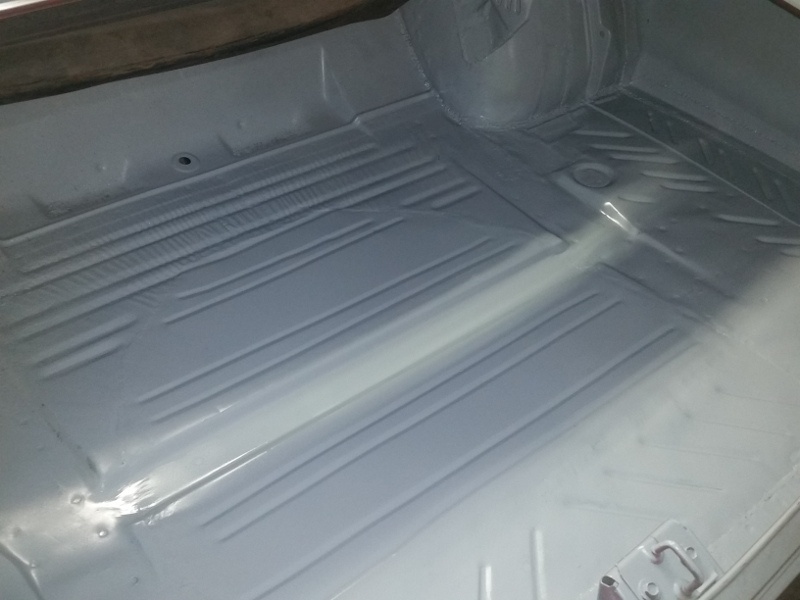

WOW, Looks great Sasquatch! I'm really liking the bead work, should stiffen it up nicely.

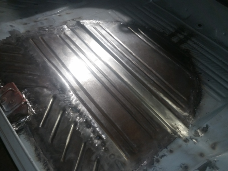

Finally the trunk is in epoxy primer . . .
Got back into the hot shop and got some more work done on the trunk . . .
First, got all the metal prep work done . . .
Then got it shot with epoxy primer . . .
Looks like I need some more practice on straight beads with my bead roller ( this was the first beads I've ever done ) . . . but the intent was to try and mimic the lines, spacing, and the look of the other beads in the trunk . . . I like the final result . . .

Like the beads and the trunk!! My next purchase is a bead roller too, so I can do My trunk floor where I cut the well out so the exhaust will exit through the 70 RR bumper.

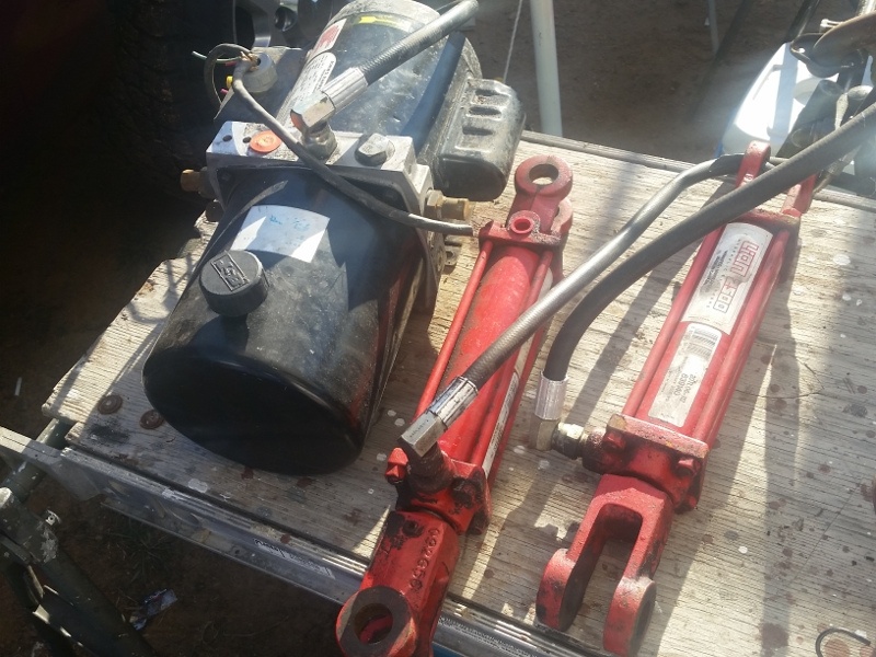

Bought this pump and ram ( thanks to 747Mopar ) to build a hydraulic press . . .
