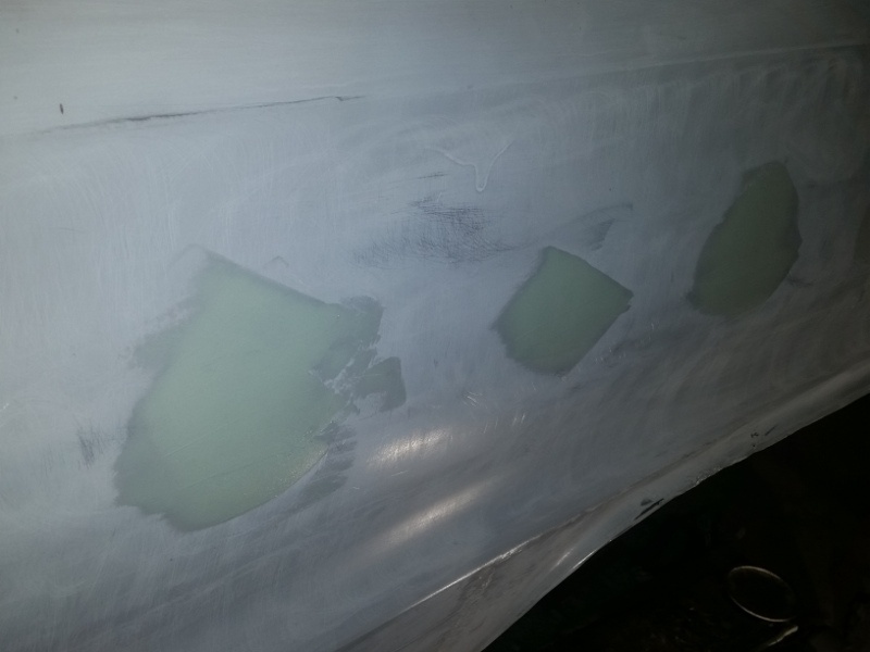

Alright . . . I guess it's finally got to be that time . . . and guess what happened tonight in the shop . . .
The first spots of body filler have been applied to the Khan-vertible . . .
Now . . . if I only had some sort of a clue what I was doing . . . that would be great ! ! ! ( wish me luck ) . . . I'm going to need it . . .

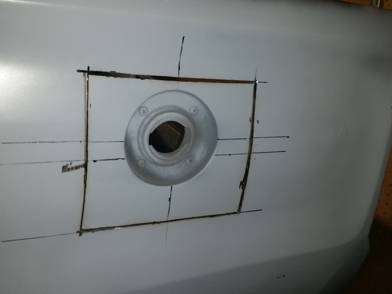

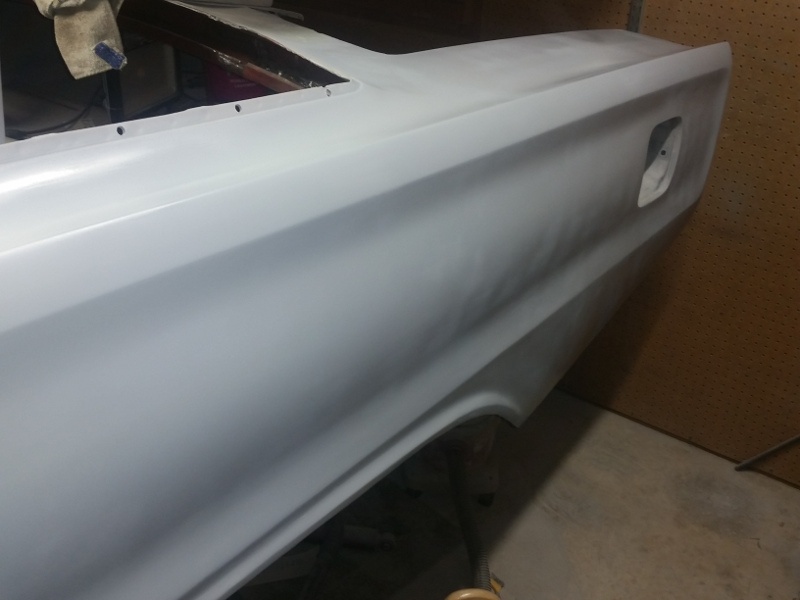

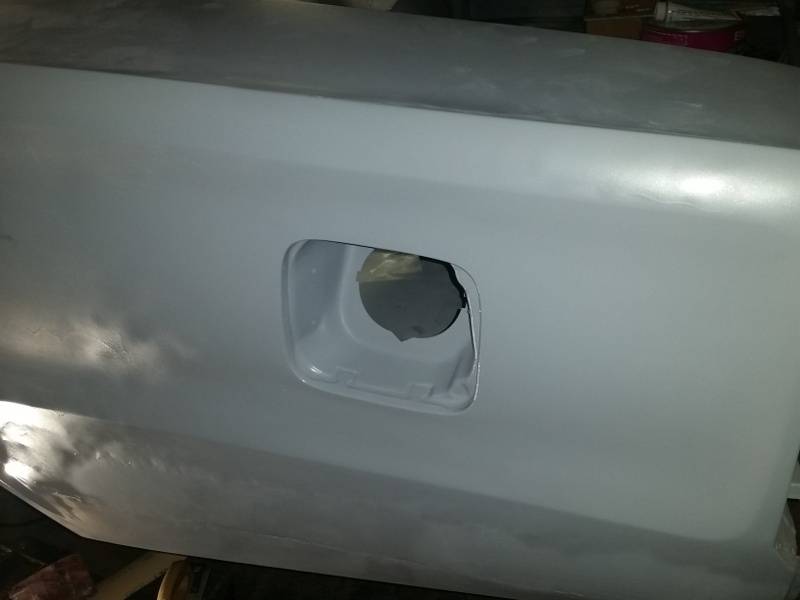

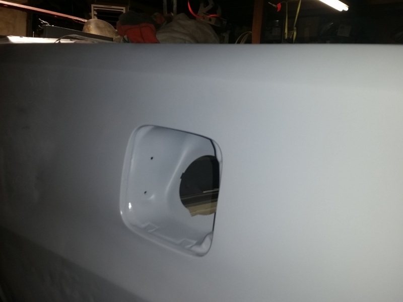

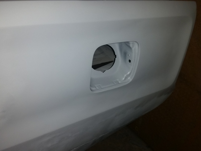

After my first stab at bodywork . . . the body side moldings that were welded shut . . . I figured it was time to try my hand at something a little more difficult . . . so I figured I'd take a stab at the gas cap cover ( I know some may not like this, but I'm going for a clean, slick, smooth looking car - and the protruding gas cap did not fit "my" bill . . . )
Let's see what we've got here . . .
Another angle . . .
Got a lot of body angles, curves, and the gas cap cover that is "close" to the shape . . . so it needed a little finessing . . .
I'm liking the way that it' turning out so far . . .

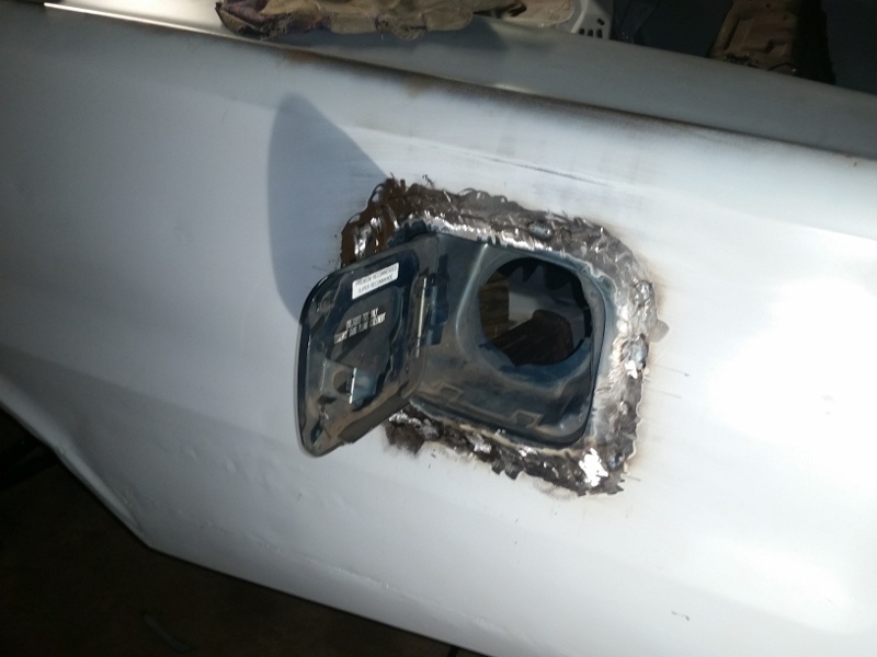

Next . . . if you look at the first picture, the whole lower area below the body line where a Khan-fabricated panel was welded in to replace the rotted out lower section that originally occupied that area of the car . . . that should be a very interesting ( and challenging ) area to "fix" . . .
Here's the original work . . .

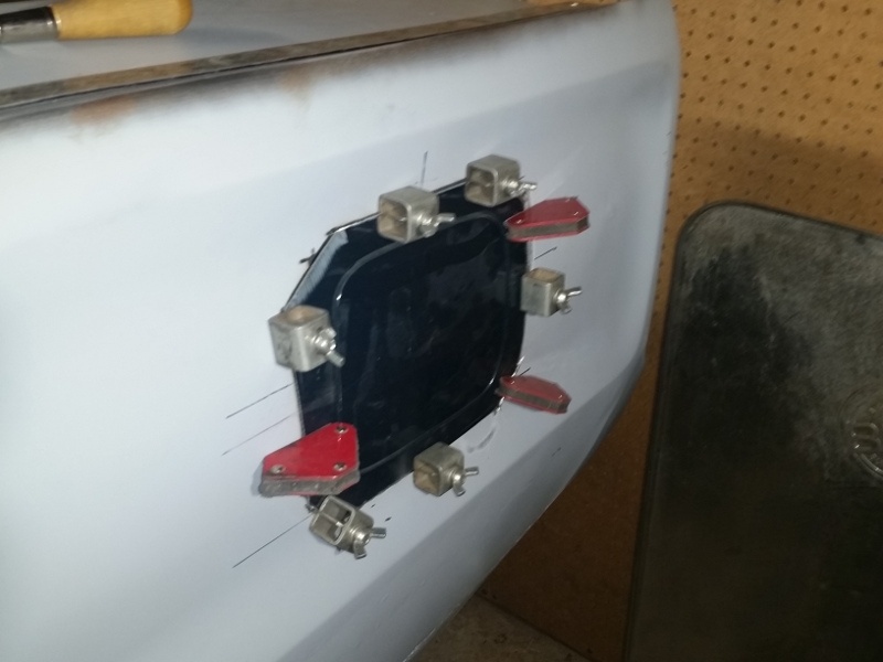

Marking the area . . .
Cut out with the new gas cap cover fitted in plavce
And finally welded in place . . .

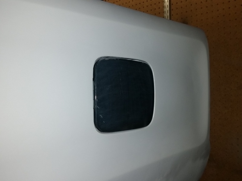

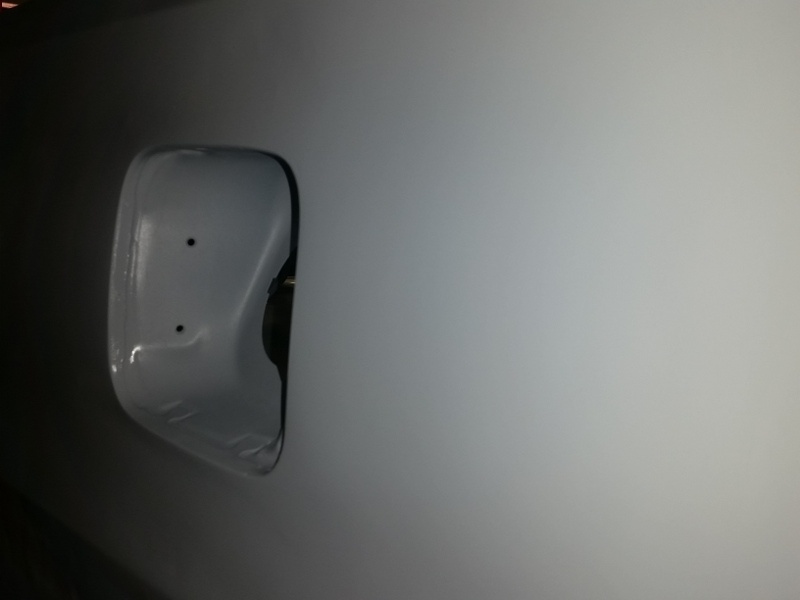

After letting the epoxy primer dry a bit, I put the cover back in place to see how it looks . . .
I like the way it's looking . . .

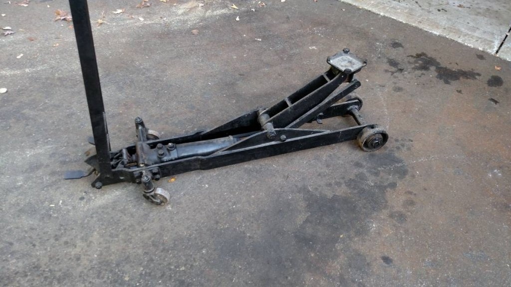

Spent (2) hours chatting with him about stuff . . . I may be going back to pick up a really cool jack that he got . . .

Got the drill press the same place that I found this . . . pretty cool jack . . .

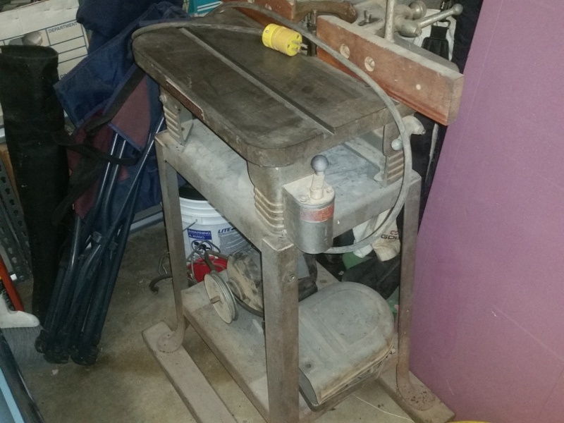

And this very nice wood shaper . . . for my wood working projects . . .
Stumbled on the guy on CL and I keep in touch with him . . . he does it as a hobby and does very nice work on the tools too ! ! !

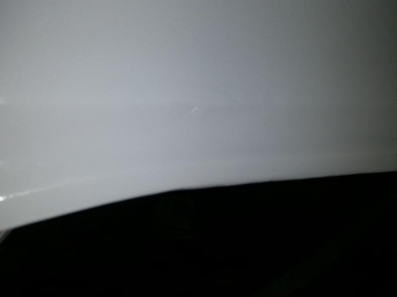

The seam where the rear quarter panel meets the rocker ( it was leaded - now filled with body filler ) . . .
yes, I've got a sag in the primer ( need some work on that painting stuff )

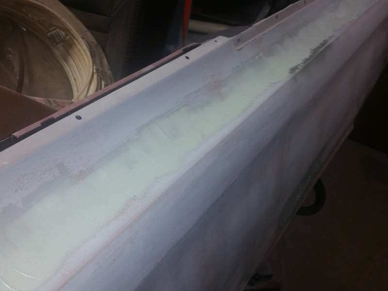

Back in the shop, while I can take advantage of the unseasonably warm winter, and try to figure out this bodywork stuff . . .
Got (2) really bad areas that I'm struggling with . . . make that (3)
this top edge, where I had to weld the panels together has a dip in the bottom - so I'm trying to fill it . . .
And this lower section behind the wheel well was cut out and completely replaced with new "fabricated" metal . . .
The side and the top area are looking pretty good ( above the wheel opening is going to need a bunch of "loving" . . . area 3 )
Same with the rear section behind the wheel well opening . . . but it's getting closer with this round of skim coats . . .
Got a couple coats of high build primer on, letting it dry, and I'll be sanding on it tomorrow ( and they're calling for 1-3" of snow for us on Saturday . . . great )

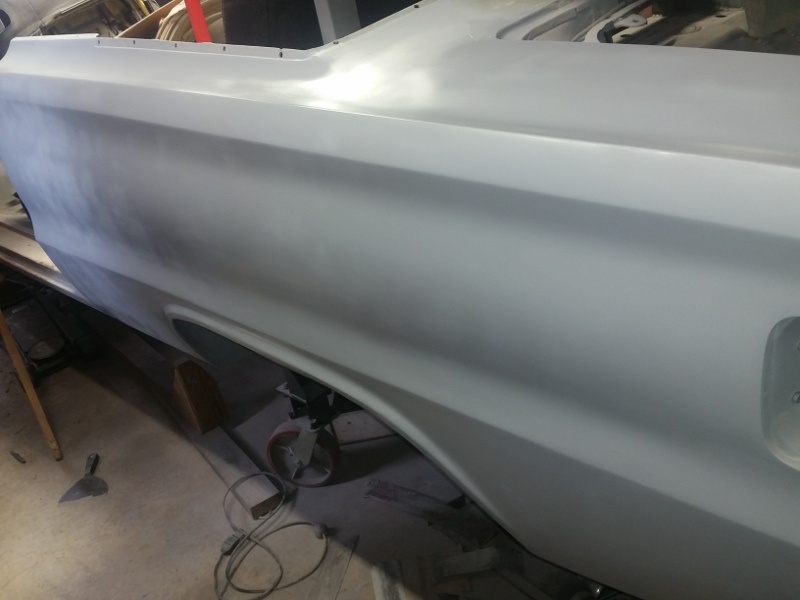

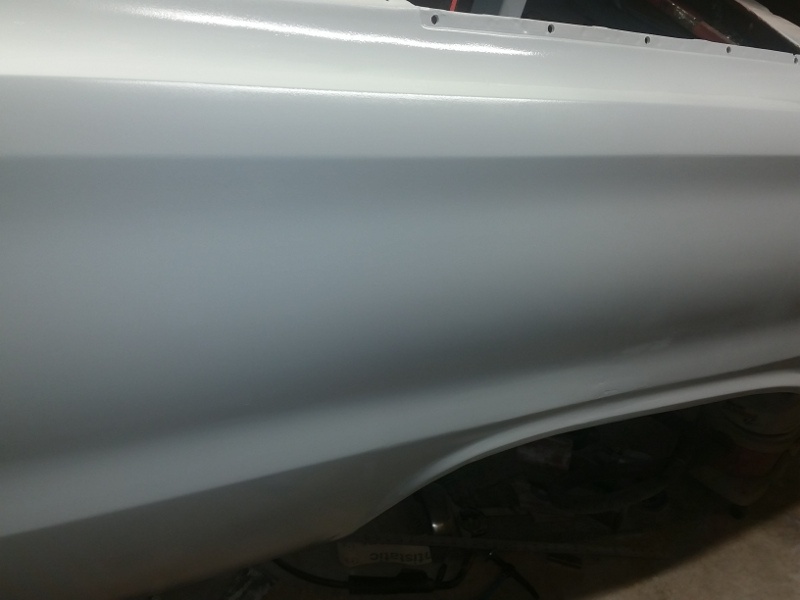

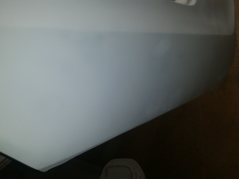

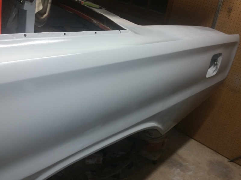

Got this side looking good, time to move onto the passenger side rear quarter panel . . .
From the rear of the car . . .
From the front of the car . . .
The top - I welded the donor panel in at the bottom of this area - finally got it looking good . . .
And the rear section behind the wheel well - I cut the whole bottom off and fabricated a new bottom . . .
Here's what it use to look like . . . look at the bottom below the body line . . .
sm_gascapcover01-jpg.379902

Man those quarters look nice and the gas cap looks like it was made that way.... nice work! Good luck moving forward on the bodywork.
