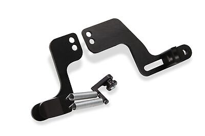

I had trouble coming up with mounts for the TV cable that would clear the throttle cable. Since I was out of ideas and the ability to make something I bought a linkage mount made for the demon carburetor. I ended up using only the TV cable mount that I highly modified. And modified the factory throttle cable mount that I had to bend it down to clear the TV cable mount. It's not a thing of beauty, but it will get the car back on the road. Once I get more time I'll refine the looks.
