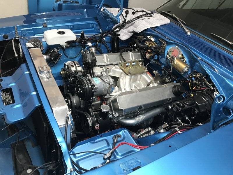

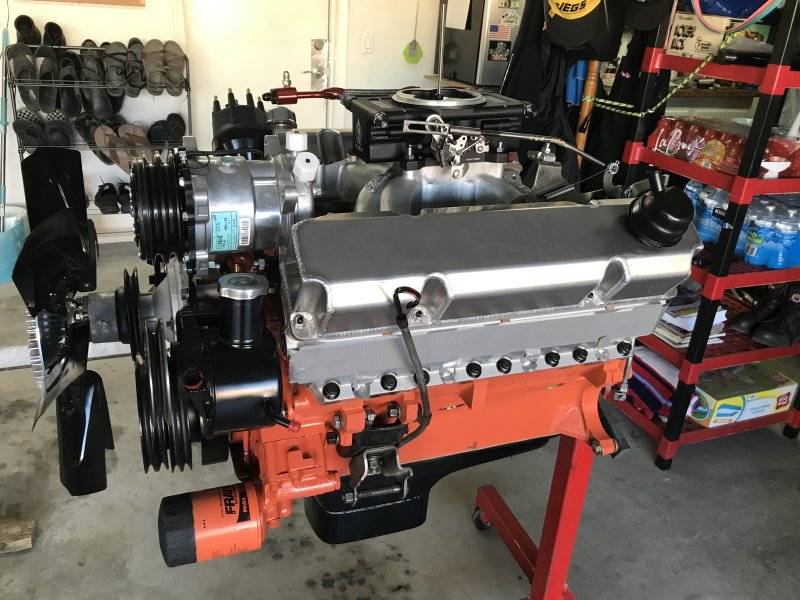

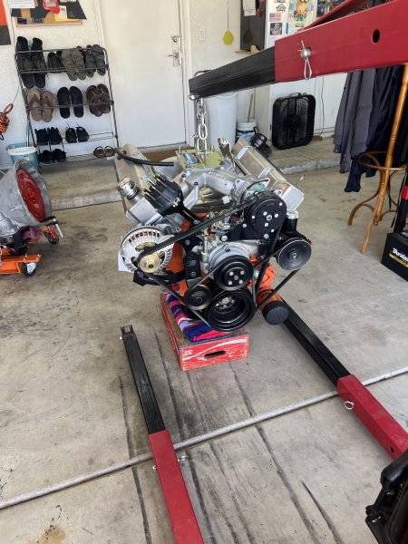

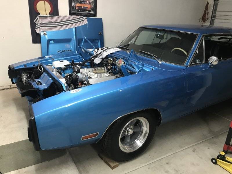

Engine mock up…
The engine looks great.

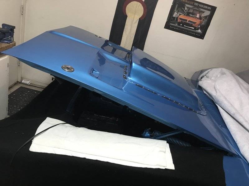

Be aware that it will not clear a stock hood. I don't recall if you have an aftermarket scoop or not but the RB block in a Charger with even an Edelbrock RPM intake and 4 barrel requires a deep drop base air cleaner.
Single plane intakes like your Torker 2 and the Victor do sit at least 3/4" taller.
I'm not trying to piss on your efforts, I just thought I'd let you know.
Thank you for your comments…. I’m covered!

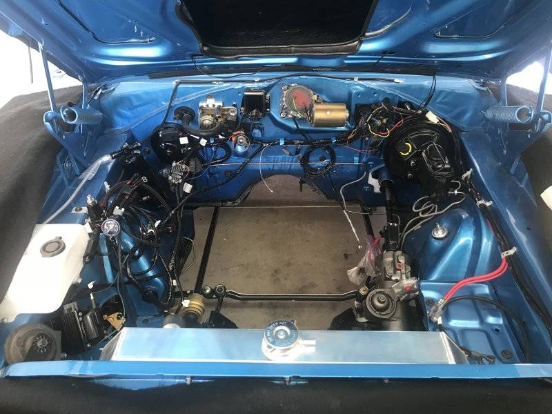

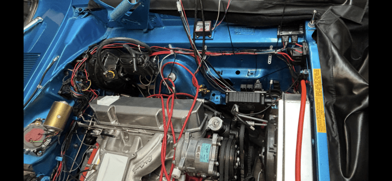

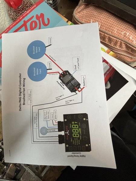

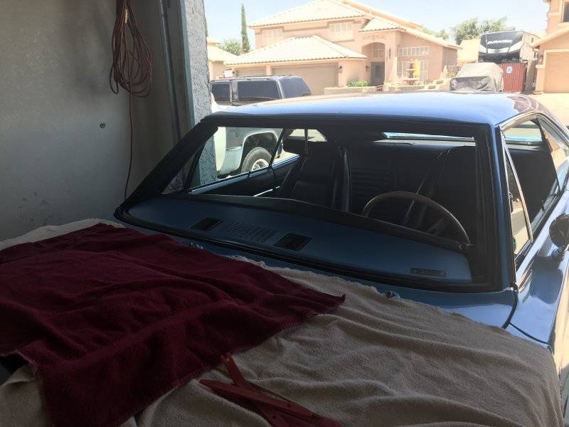

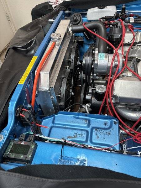

Update: finish off trunk area. Installed rear window. Completed engine bay wiring for electric fans, Aces Kill Shot fuel injection computer and new Engine sensors for Fuel Pressure, Engine temperature and tachometer output.

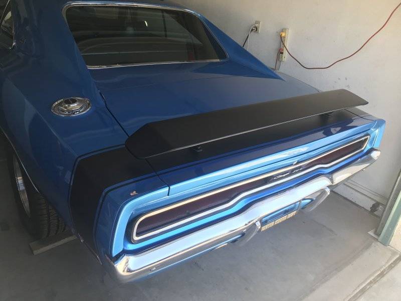

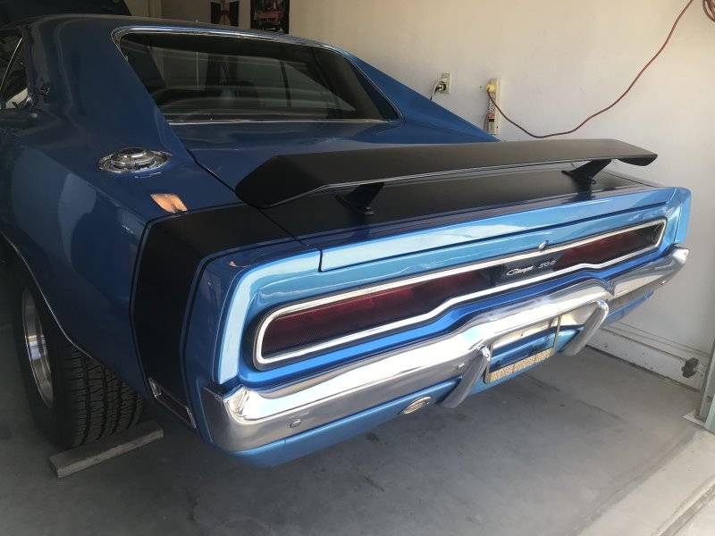

Finally was able to get the stripe installed on the car. It Took me two tries. 1 to 10 I think it’s about an 8.

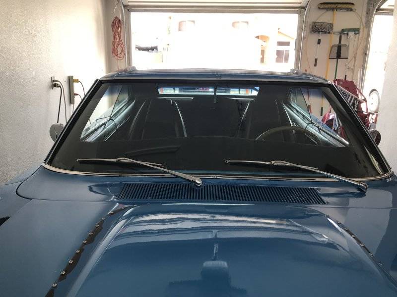

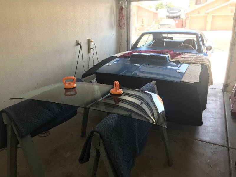

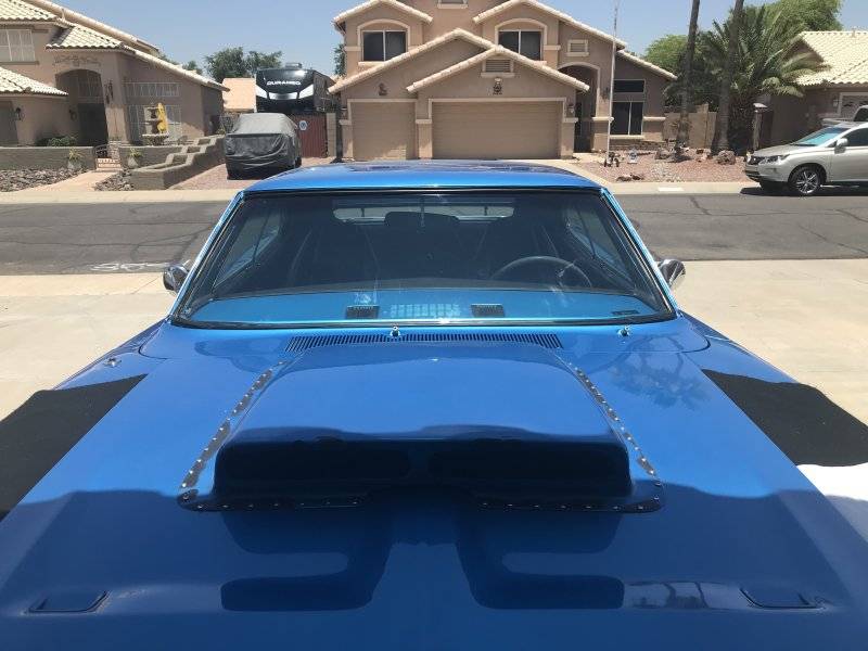

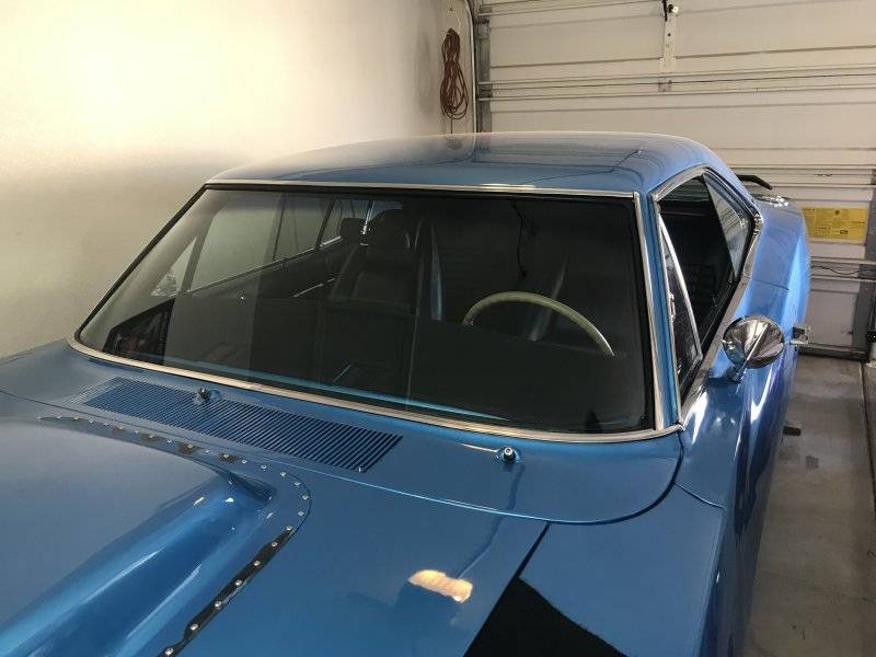

Installed the windshield today. One more thing off my to do list. Getting closer to first drive day!!

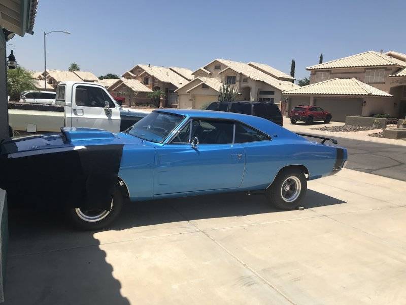

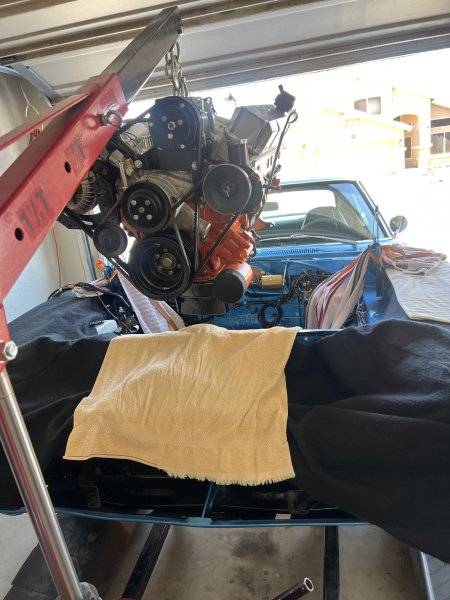

Major work was completed in last 72 Hours. The engine and transmission are in…. Transmission rolled of the jack once today, but no damage. Everything fit, but very Tight clearances…. But I got it done!!

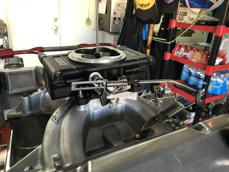

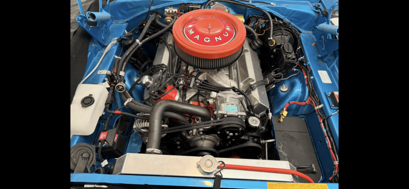

After 5 year 8 months the Charger fired right up with the aces fuel injection. More to come! Soon!
Removing Aces EFI…. ECM just died No reason whatsoever. Aces wants it back to test. I’m going to re-sell the aces stuff and install new 850 Holley carburetor. Never had a Holley just die….

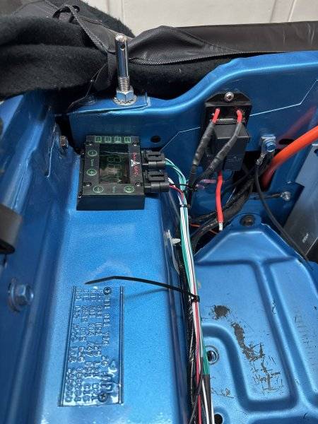

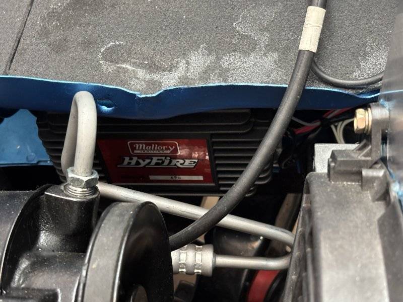

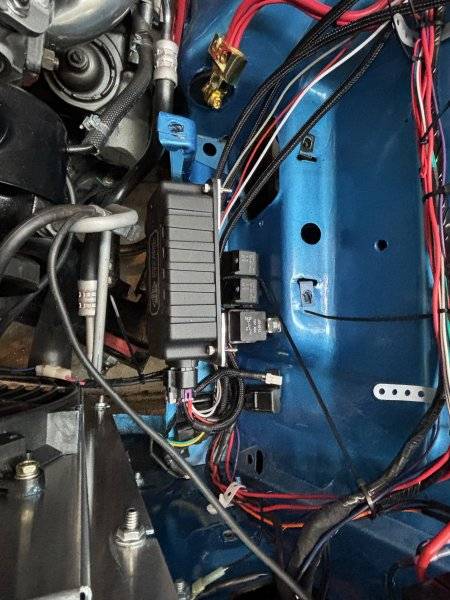

Installing the ace‘s ignition system, and tach signal booster. Not much room to mount this stuff, had to make brackets. Ignition and relays for fan controllers under battery tray, fan controller panel and tach meter booster signal module mounted on driver side next to the battery. Hope to have the car running in two weeks.
Installing the ace‘s ignition system, and tach signal booster. Not much room to mount this stuff, had to make brackets. Ignition and relays for fan controllers under battery tray, fan controller panel and tach meter booster signal module mounted on driver side next to the battery. Hope to have the car running in two weeks.View attachment 1839220View attachment 1839221
The Aces ignition failed right out of the box.
ignition system has been totally updated with Mallory system!! She purrs like a kitten now!!
