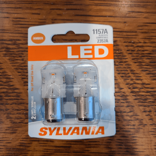

I installed this type bulb from Sylvania in my road runner and cuda. I highly recommend them and be sure to purchase the correct bulb, red for brakes/turn and amber for running/turn lights.

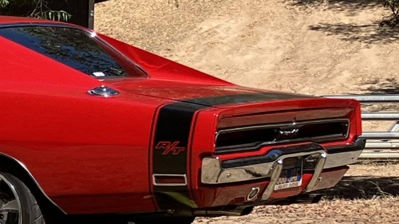

The 1969-70 Chargers had tucked in lenses that look dark until they are lit up. My taillights seem bright enough here:

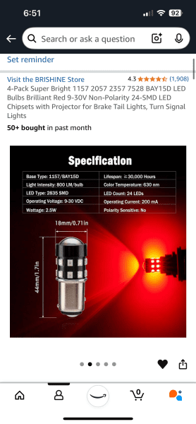

It seems like the brake lights should be about twice as bright as the taillights but for me, that isn’t the case. Are LEDs the only way to improve this?
