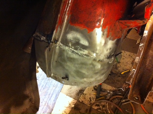

Did´nt find any welding primer but Zink spray worked just as good, tank strap brackets and spare tire bracket are in place.
Damn it takes time fixing this rust...
Does the black AMD coating work as a primer? Shall I just rug it up a little before top coat or some kind of bedliner? It must be easier to do that now instead laying under the car and paint it...
Try to leave as much as you can on it. People refer to it as E-Coat, simply put Epoxy Primer Coat. I don't know if you caught it over on my resto thread, but I scuffed the e-coat with a 3M Scuff/finishing pad (till there is no shine left to it) coated with rust bullet, and then sprayed on the bedliner in the trunk area. Mainly because that's where these cars love to leak and rot out.
On the outside of the car, i'm leaving what I can on, but by no means is it the only sealer/primer base for the car. There are much more appropriate primers/sealers to use as the main foundation for the top coat.
Hope it helps! Progress is looking great..
Looking good Swede!!! Keep it up.
On the e-coat issue I’ve talked to my paint supplier about it before. They say the e-coat is primarily to keep the parts from rusting in the warehouse. Whatever you will be priming your car with (DP-90, filling primer, etc) you will need to paint that over the e-coat as well. And with what primer you chose you might need to do something different to the e-coat. For example DP-90 requires a different primer to be applied to the e-coat before applying the DP-90. You may or many not need to scuff up the e-coat as Cranky stated. It all depends on the primer you will use. It’s as easy as reading the instructions first. We all do that, right… :Groaner:

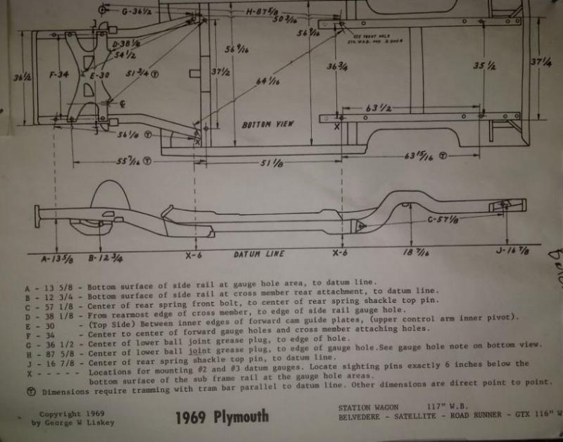

Also have one question about measures on the rails, on Donnys thread there is a pictures that I took and the question is if the measure C is the same for a 1970 Coronet? I guess so, but I want to be sure.

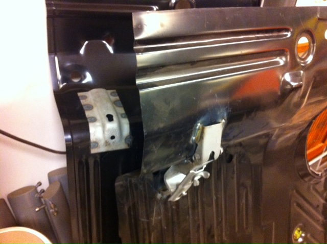

Update, waiting for the new parts I was planning to assamble the drivers door, you know that 10 months project that usally takes one day...

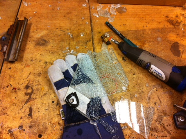

Had some problems with a missing hole in the -68 window so I bought a diamond drill planning to make a hole but with raising age so comes knowledge, lets try it first on another piece of glass!
Found a vent window for a 4 door and started drilling with water as a cooler, worked real great until Booom! 10 000 pieces of glass all over the shop, damn, I am so happy it was not the new window I blew up!
I skipped the hole...
Next was to put in the window in the door and it worked out OK, it was not so difficult that I thought, will take some pictures.

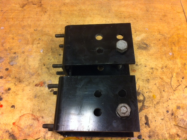

Third project was to drill the front hangers so they fit HD springs and SS springs too, piece of cake, I will start with the springs in the lower hole and if necessery put it in the upper hole, lower the car by an inch and a half if it gets to high with the new springs.
Anyone know where to get new bolts for the spring?

is there a hardware store that you can take the old bolts in and match them up to new ones?Or maybe pst suspensions would have them.
Due to the metric system it is really hard finding those bolts over here, the only positive with the metric system is when measuring body parts:icon_mrgreen:
