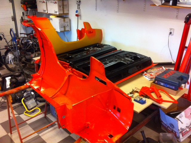

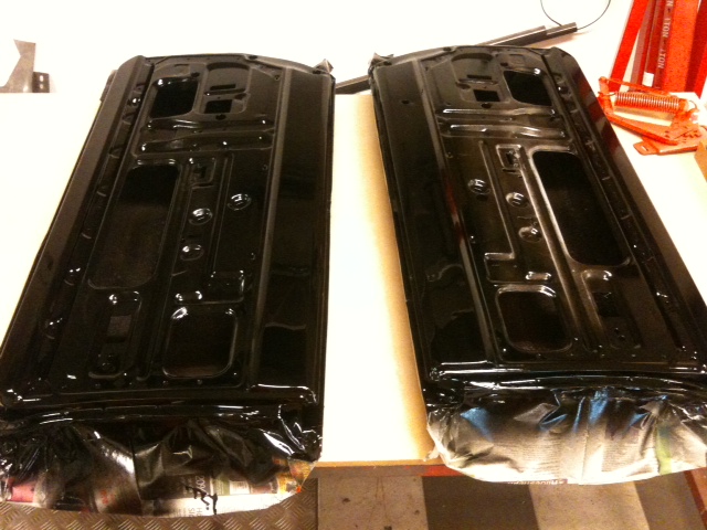

What a day!, blasted and painted the hinges for the doors and the hood, painted inside of one fender and it already has primer on the outside, then I painted the inside of the doors, but I have to paint the black part one more time due to bad craftmanship..., I am a lousy painter, I will only paint insides of the car and small areas that never will be seen again...
Only one more fender to do before I begin with the trunk, bring it on!

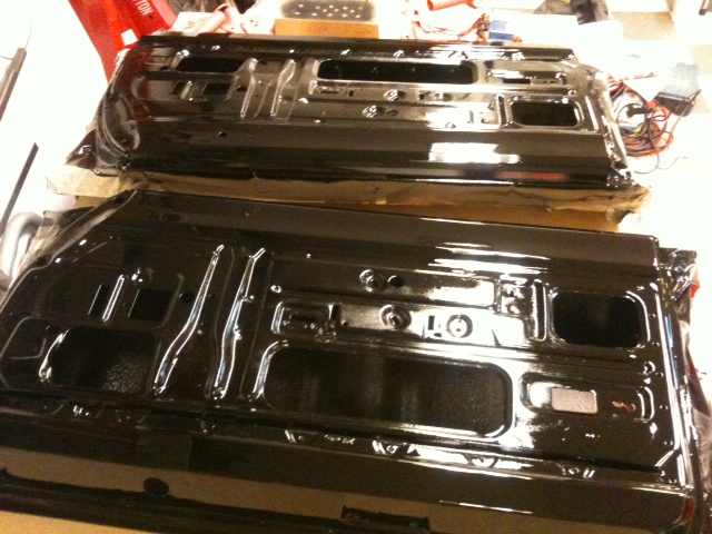

Finally got paint on the the doors so I can start to put them back togheter, it will probably take me the whole winther....
It has been 4 week with no work on the car, I better shape up!

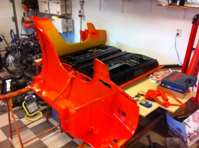

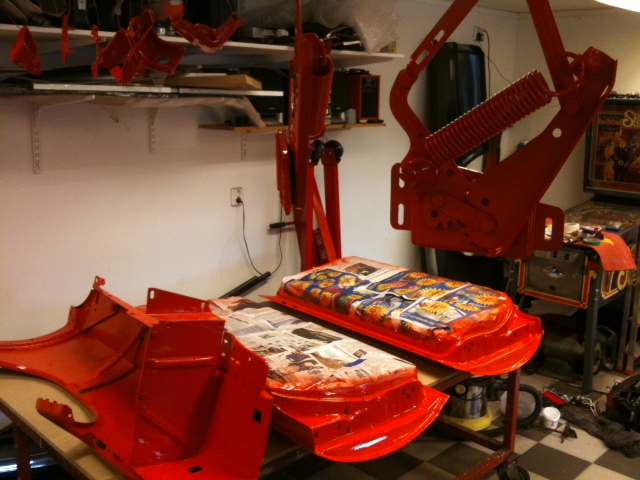

I guess it is time for an update, I got a new job so I have not have so much time lately to spend on the car but this weekend was great, I finally got paint on the last fender, took it down to bare metal, welding those trim holes and put on some epoxi primer, then coating the inside with elastic body coating and finally some 2K top coat, It will never rust!
I am leaving the dents to the pros, at first I was planning to to all the work including paint but what takes me a month to do will take a pro 2 days...
The next project is to prepare the b-pillars so I can hang the door, (paint etc.) I hope to have the drivers door in place next weekend.

Did you blasted the inside of the fender to get bare metal??
Roadrunner199, I did not blast them completely on the inside "like Donny would have done", I took all the edges and spots where there was a little rust, the fenders was 99 % rust free from the beginning and I took a 3M disc to remove all the paint on the outside so it won´t hassle with the new paint. I am a little afraid of blasting to much due to warping.
