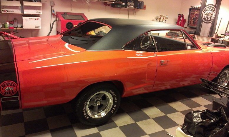

My Coronet project

BTW, got my new 10" drums and new wheels too, lowered the car about 2 " so the ride height looks better now, slowly slowly the car is coming together.
Also got new exhaust tips in stainless that looks great.

I did a great work yesterday painted the white rubber moulding in black (around the backglass), will try to mount the package tray, sailpanels, mouldings and backglass today.
Updates will come!
That is really a sharp looking car you have there. I like your wheel choice - they go great with the car.
Backglass and sailpanels are in place, struggling with the cat whiskers and the drip rail mouldings, can't get them over the rails due to the extra thickness of the vinyl, if I lift the vinyl they fit like a glove on the bare rails, thinking of lifting the vinyl and grind of some metal then glue the vinyl back on, what do you think about that?

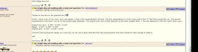

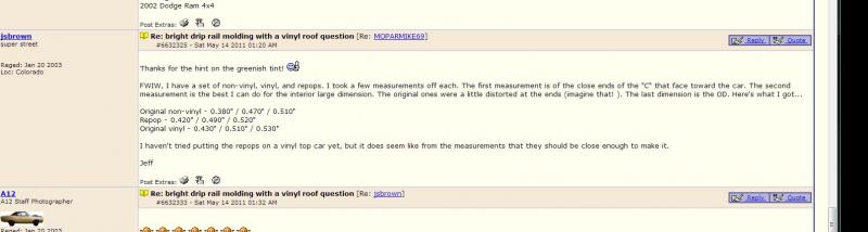

Joakim.....Here's a post from Jeff at 521 Restorations over at moparts that may be interesting to you:
http://board.moparts.org/ubbthreads/showflat.php?Cat=&Board=A12&Number=6632325&Searchpage=1&Main=6628572&Words=+jsbrown&topic=&Search=true
You know as well as I do that the original factory stuff is always better than aftermarket/repop, but seems you're in quite a pinch. I'd say shaving that 64th is going to get you there, but man that would be tough picking up that grinder/sander on a car that far along. Never the less, a guys gotta do what a guys gotta do. Good luck whatever route you go.
