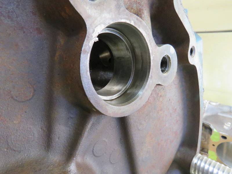

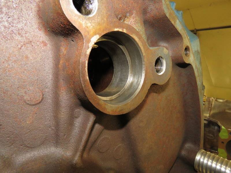

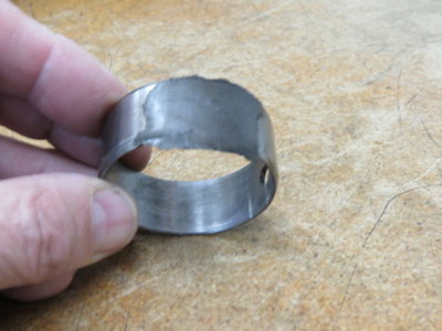

              So I got an email from Hughes Engines today regarding the block that I dropped off. Not good news! The number 5 cam bearing bore is way out of round and was repaired with epoxy (JB weld).
              C9E62C35-6094-43E7-B29A-DDEFEE354EB4.jpeg C3DB14DF-E779-4678-8B1E-C0C7433C7906.jpeg 226C6554-DFA3-42EE-BC05-3DBAA24662A3.jpeg

              how much os to fix
              .010 bearings are available or you can bore and sleeve back to stock
              or if roller cam you can go to 55mm or other

              Wow, I never seen that before

              you just had to take that cam bearing out did you not?
              it looks like it was working fine
              rear of cam sorta just floats there anyway unlike a SBM with the oil pump and dist back there

              How the heck could that happen? Seen a cam bearing spin in the bore but too have a gap on one side...that's a new one for me too..
              Looks like someone messed up machining it. Like the mandrel slipped?
