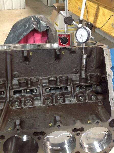

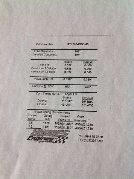

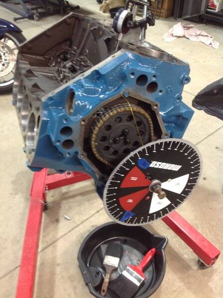

Lifters are in, all rise and fall under there own weight and rotate properly when cam is turned. So all good there. Teaching myself to degree the cam, seemed intimidating at first. Following the instructions provided by Hughes, I now have a good understanding of what to do. Is it common practice to only check cam on cylinder 1 or do all lobes need to be verified?
Is a cam button required with mechanical lifters?
Thanks in advance
