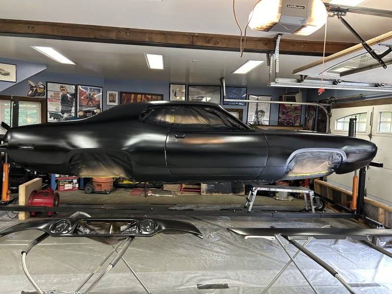

I sprayed some more GY8. I got the engine bay, backsides of the front and rear valance’s, hood springs, battery tray and radiator support done. Next will be door jambs and interior.

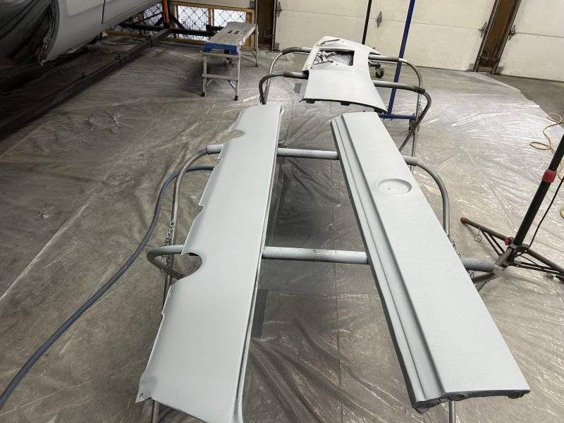

Hello all, I got the interior, inside of doors, hood, trunk lid, header panel, fenders and door hinges painted. A lot of work and a lot of paint! I’m going to have to order another gallon of GY8, clear and epoxy to do the exterior.
Hood, trunk, doors, fenders, door hinges and a ton of bolts:
Trunk:
Interior (roof too):
I’ll be cover much of this with sound deadener (interior) and undercoating (fenders/cowl sides).

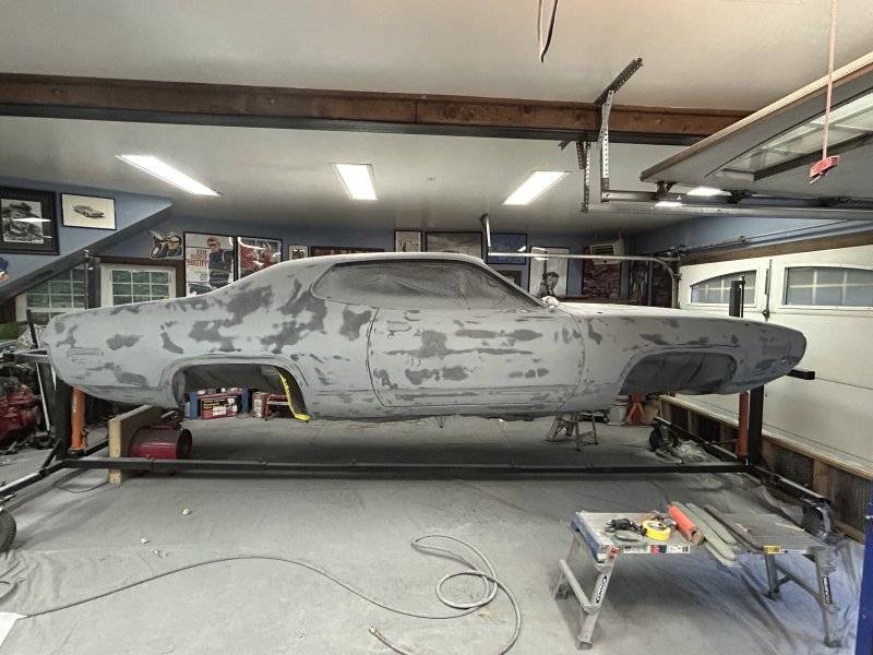

I started blocking out my Road Runner. After scuffing the entire car with 180grit, I sprayed two healthy coats of SPI epoxy. I let that dry for a day and started applying the filler. I didn’t use any on the quarter panels as they look pretty good and I figured any defects would be fixed with the high build primer. After what felt like months of guide coating and sanding, in reality 9 days, I covered the car in two more coats of SPI epoxy primer. I let that dry overnight and then sprayed two heavy coats of SPI turbo highbuild primer. I’ll let this sit overnight and start guide coating and blocking again, yea!!

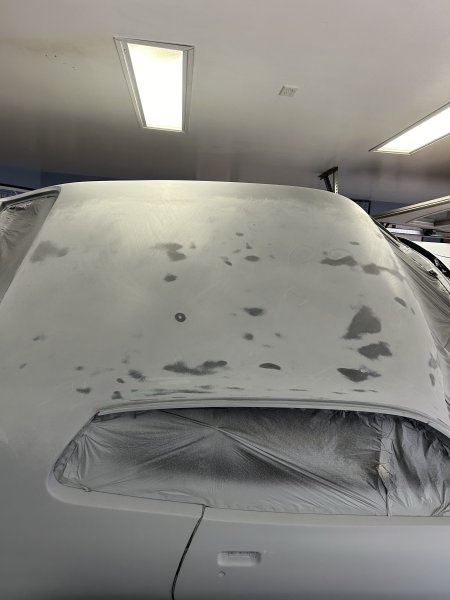

Progress; I blocked the high build with 220 grit. I then tapped down the highs and glazed the lows. I also sprayed more epoxy over any breakthroughs down to metal. I then sprayed three more coats of high build to start again…super!

I can’t wait to start sanding again!
