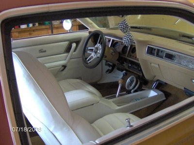

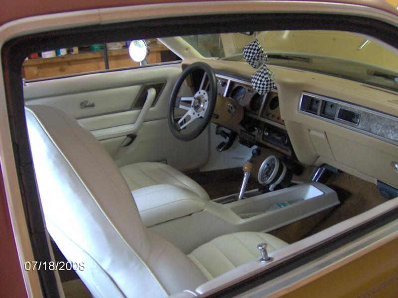

Please don't laugh,, but I have found great dyes at the local shoe repair shop.My interior is red and they had a shoe spray dye that matched. It has been 2 years and no wear or flaking. Made the parts look like new. I know shoe shops are few and far but worth looking for in your area.
I ordered the dashcap from Dashcaps.com (it's listed for a 75-79 charger). The dye is an SEM product that I got from a local auto paint supply store.

That one turned out real well for you. Nice work. I used Dupli Color Adhesion Promoter as a primer before painting the vinyl surface. I never used this before but was advised to do so by a who does a lot of small repair work for our dealership. There are other products like this, I'm sure SEM has a similar product. But it really helps to keep the new paint/dye from pealing off etc.
1toolguy, that dash cap looks good. Well, your whole interior looks good.

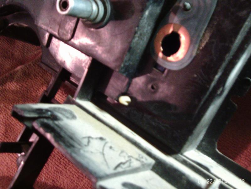

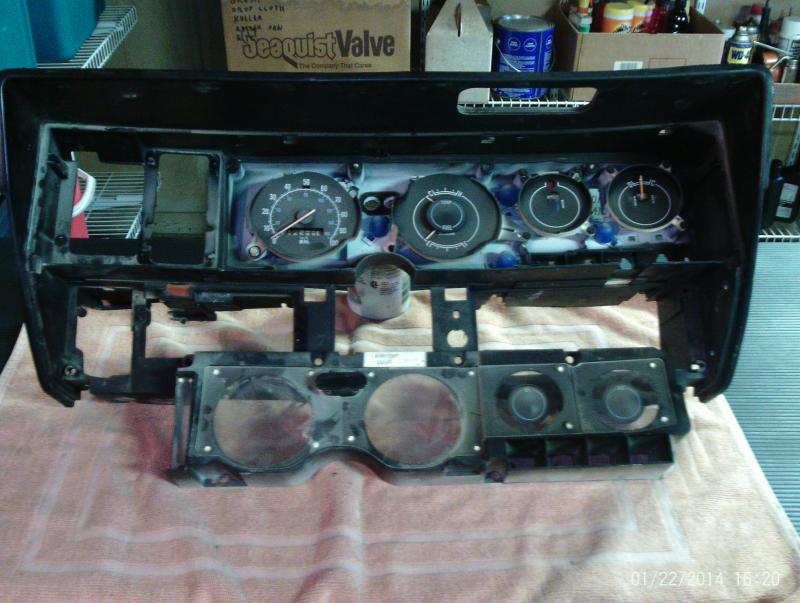

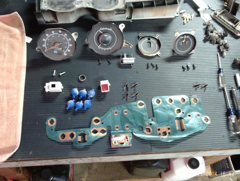

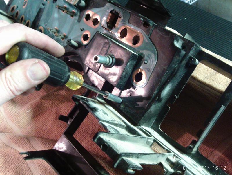

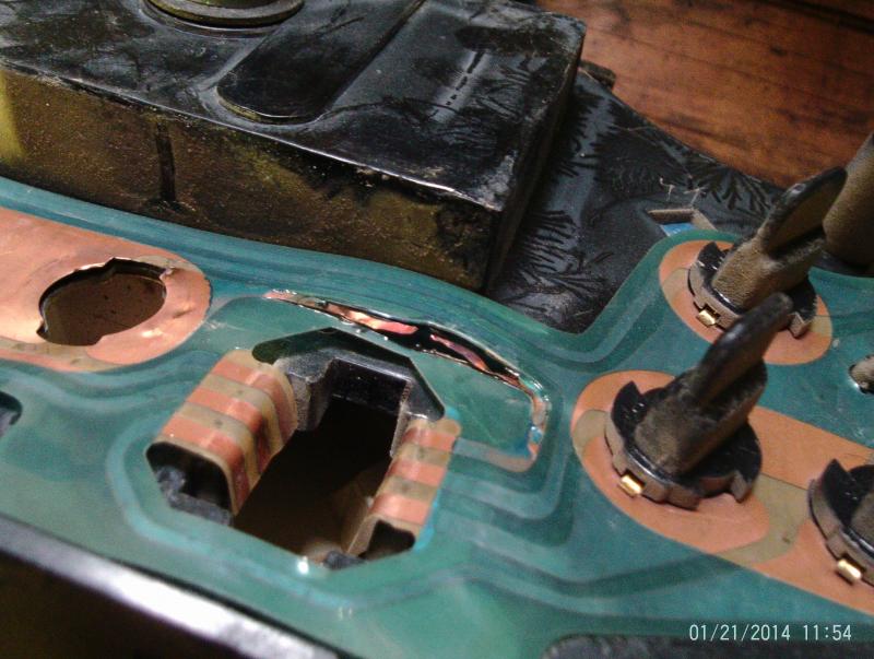

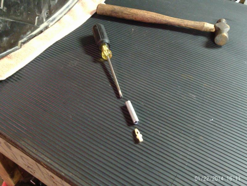

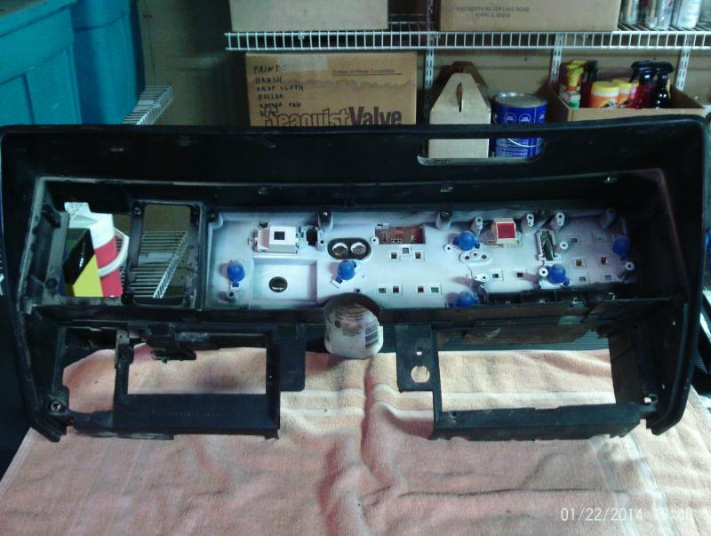

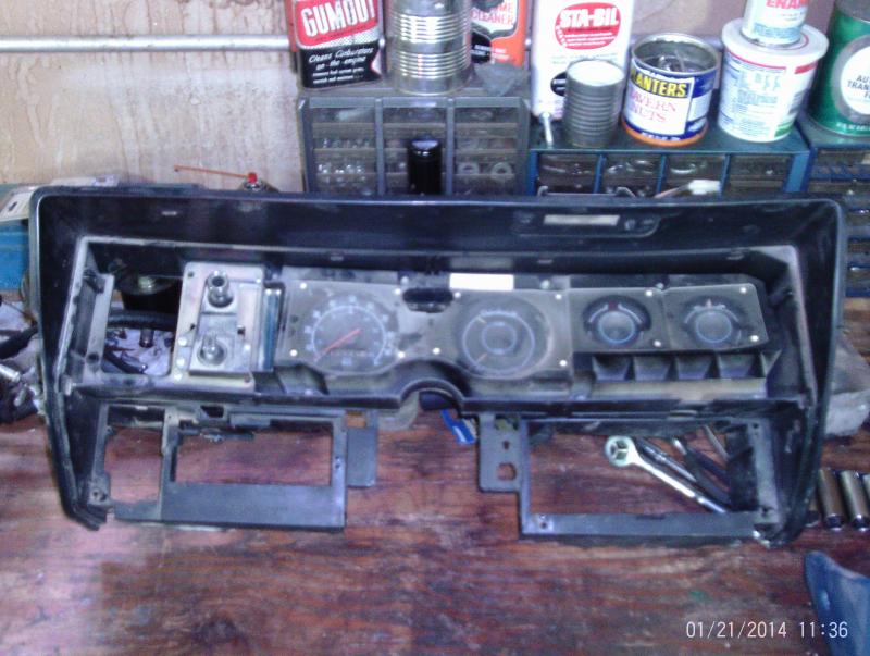

Here’s some pics of my instrument cluster disassembly. It is filthy. I made a tool to remove the plastic rivets. After I get things cleaned up I’ll start testing things out. My PCB has a bad trace but I think I can fix that. I’m pretty sure it is for one of the instrument lights or high beam indicator.

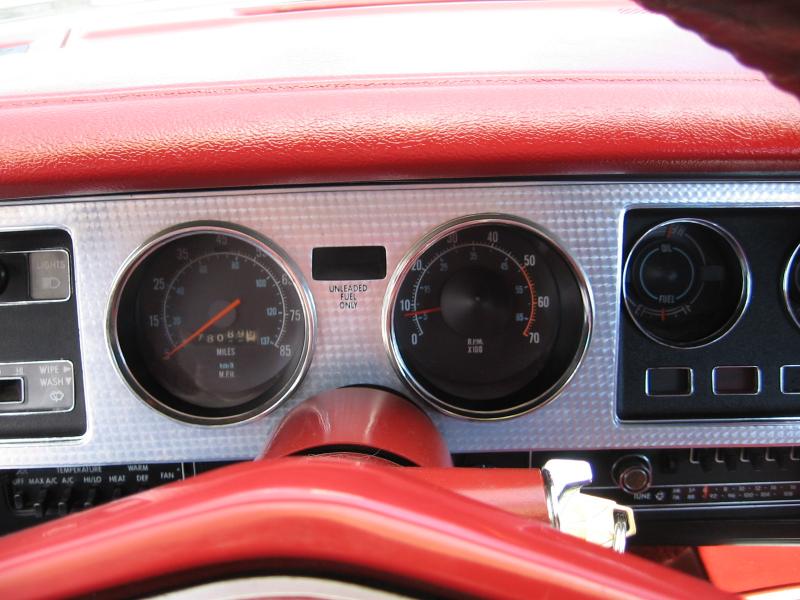

IMG_1693.jpg Just a thought,,,Google Wildcat auto wreckers.They have several 79 cordoba 300's they are parting. They have Factory Tachs.The whole pannel should plug right in and your harness may be wired for the tach,, if not add a tach wire.Just thinking out loud..

About the tach...75-76 b-body use a blue printed circuit board and 77-79 use a red one. Either can be used in any year with a simple move of a couple of wires. I did this to my Cordoba earlier this year. Mid 70's b-bodies had the best gauges of any midsize car and a 140 mph cop speedo that is a factory part could be bought over the counter...take that t-bird and monte carlo!

As for the plastic rivets in the dash, I just use needle nose pliers to pull and replace them in the dash. On another subject Jeep used 8 1/4 rears in many models. I believe that they are 27 spline axles all the way to 96, after which they went to the 29 spline axles. On My 77 Cordoba I managed to squeeze 235/70-15 front and 275/60-15 rear installed on factory rally wheels by Bell Tire metro Detroit.
