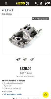

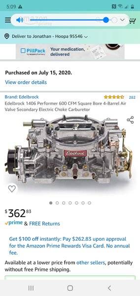

Think this is going to be a good set up with this carb and intake?
Man those are expensive!
A 750 cfm is about $100 less your motor will run just fine with it I've run 750's on all my small blocks for the reason there cheaper!
I got a Holley 600 it's used probably needs rebuilt but I'll take $100 for it
I should of asked befor I bought that one...

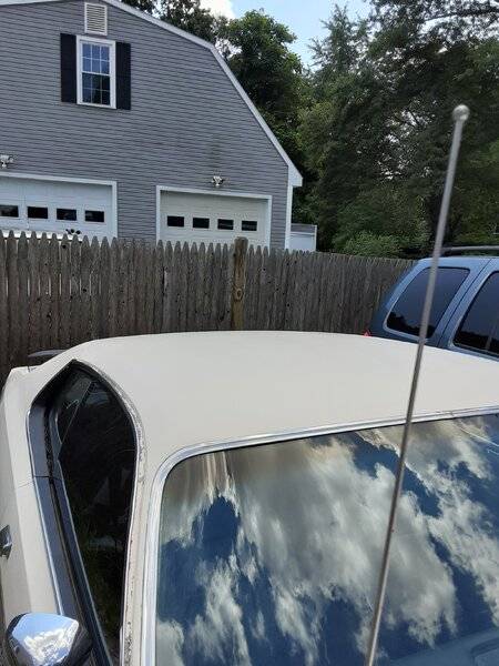

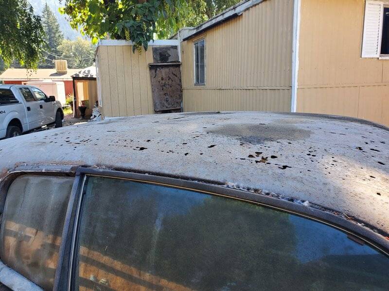

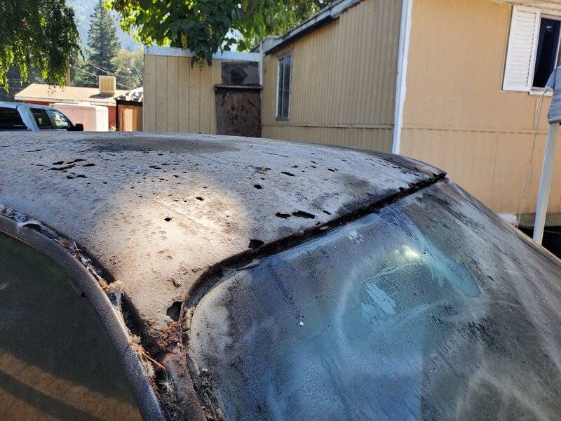

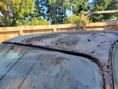

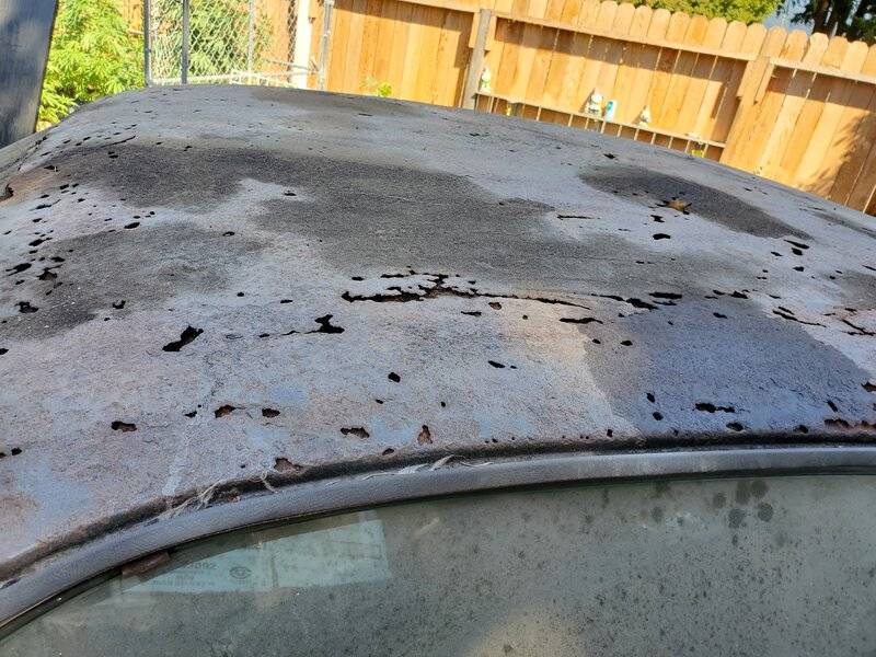

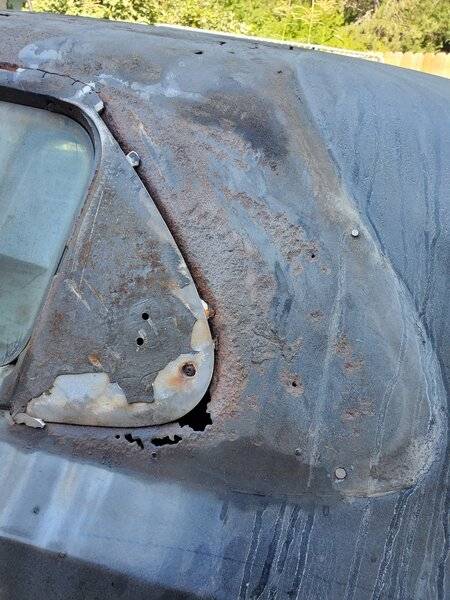

My almost rust free car looks like this without the soft top on..........sad day in America.....
What should I do about it....please note I'm not made of money...
I might just bondo the hell out of it and fix it down the road..
20200716_104241.jpg 20200716_104232.jpg 20200716_104228.jpg 20200716_104216.jpg 20200716_104205.jpg 20200716_104155.jpg
Ehhh wow that's one of the worst roofs I've seen . I'd definitely look for a roof skin but until then osfo the crap out of everything and mud it up ! Might want to us dura glass the mud will probably pop out
I haven't heard of either of those ill be sure to get them
The osfo is a rust inhibitor I might have spelled it wrong the dura glass is Bondo brand it's a bit more forgiving then Bondo once installed just duck tape the holes from the back side so you don't waits a ton filling in holes they have that metal net stuff that would give it something to grab on to . But duck tape works just fine I've done patches in past to just get it to look good not leak till I could afford the metal to fix it .

That roof is as rough as they come. In my limited search I have not found a repop roof skin for the 71-74s, you may need a donor car top. With the size of some of them holes, I don t think any bondo will stay. A possible temp solution would be to fiber glass the glass mat to the underside the roof and then skim coat the top with filler. OR, glass mat the top and either paint it black or hide that with a new vinyl top. Could get you by till replacement time.....jmho...

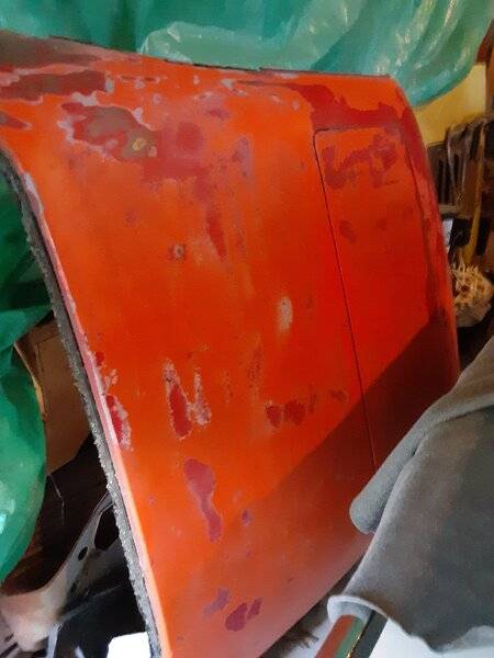

The roof on my 73 Charger was way worse than that. When I finished pulling the vynal top off,my car looked like a sunroof car,but it was not one! The rest of my car was rust free,from southern California. I got a donor car,and swapped out the roofskin. I also swapped out the SE quarter windows for rollup Charger quarter windows. Of course this complete sunroof roof was found after I already changed the roofskin!

You'll need the window regulator s and glass! The weatherstripping Chanel for a hard top car . Just knock the Bondo out see what the metal looks like under it it's just a plug they stuck in there !
Inside you'll need different interior panels the sail panel being the hardest and most expensive to get the trim on roof is different ext. Same with upper door panels
