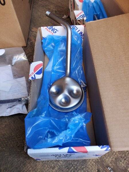

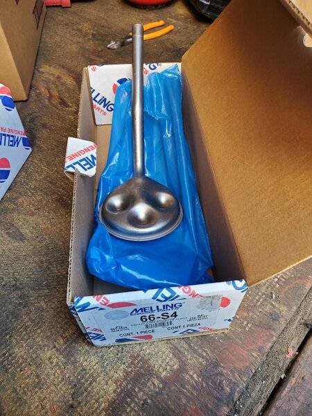

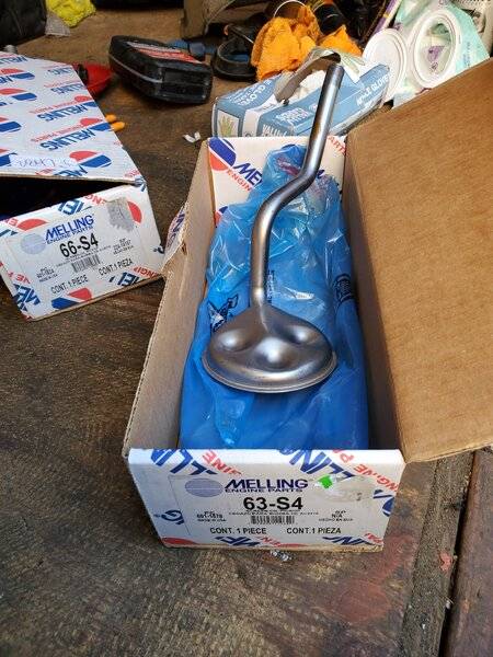

Ok 10 points to who can't tell me witch pick-up tube is the right one. I'll be able to verify when my oil Pan shows up on the 10th. The parts store said they had 3 different ones so I order them all and ill return the wrong ones
