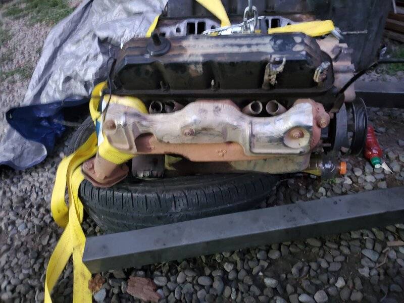

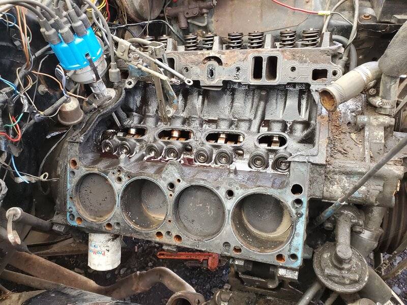

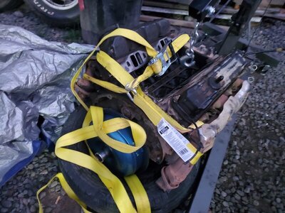

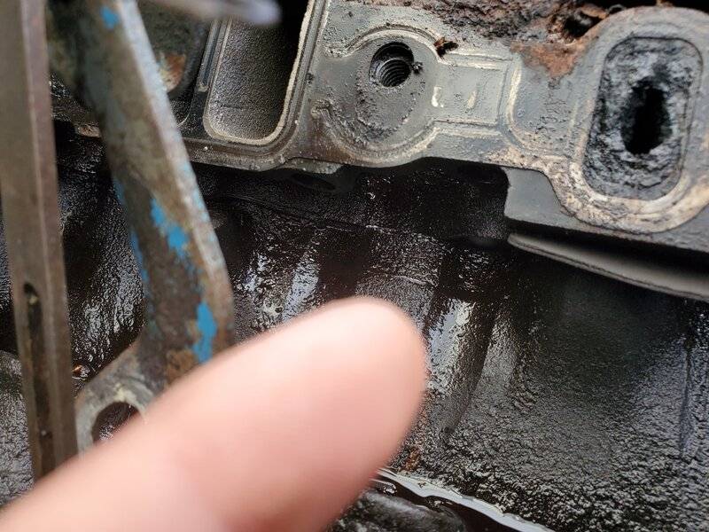

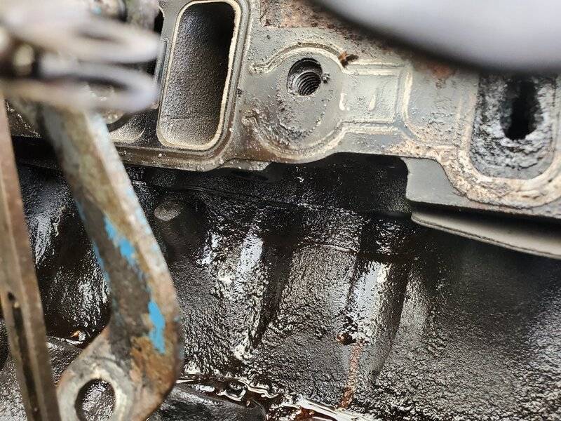

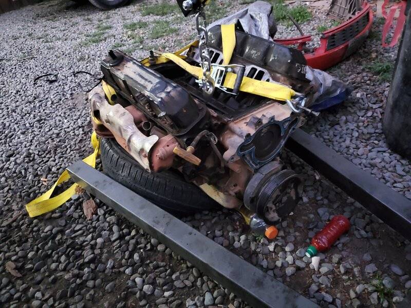

.......so the block is cracked.....i hate that when I bought this car it starts and runs so good and it had a cracked block the whole time...sure would like to take a bat and smash the car right now....
I got one head off and I can see a crack under the other head..
