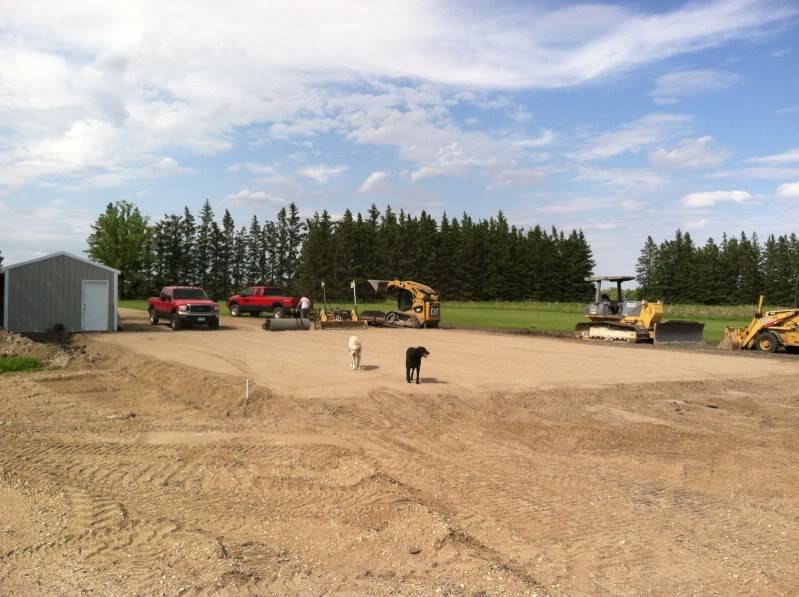

My new shop.
I though Texas was flat. lol.

A little more ground work is complete. I'm sick of ground work, I want to see some concrete! lol!
No wonder it's taking so long there Dave . . . you've even put the dogs to work compacting the site . . . think that's going to take a while ! ( SMILE )
Hope you get concrete down soon . . .

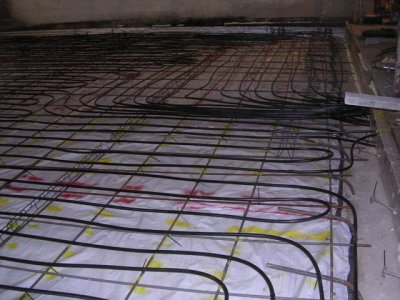

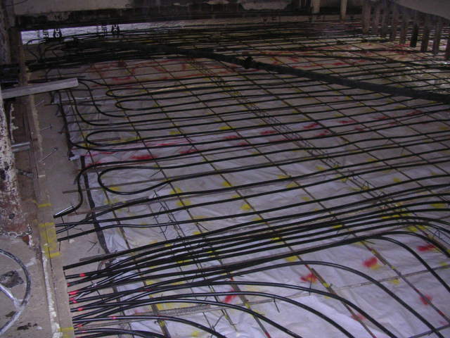

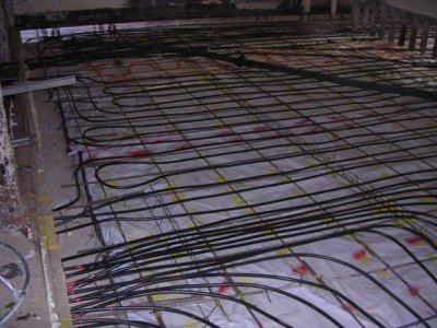

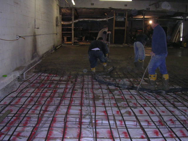

You can't beat radiant heat. Here's my yet to be completed radiant heating system. I can truly say been there, done that!
