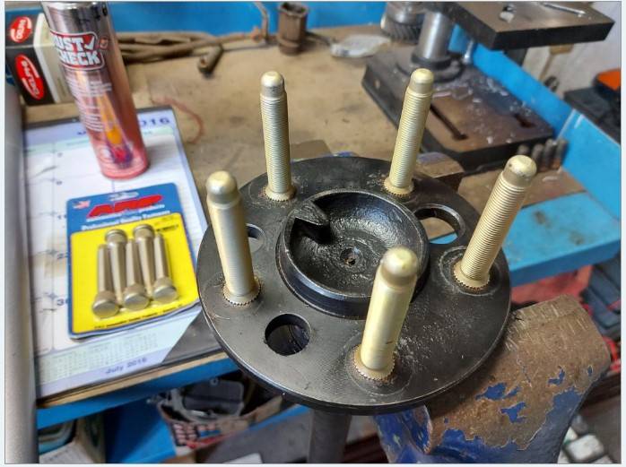

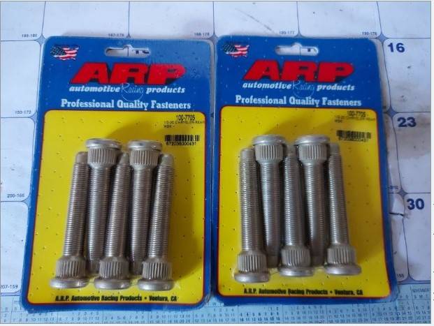

Here's what I used for the rear on my 71 Runner.
8 3/4 with 10" drum brakes.
