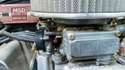

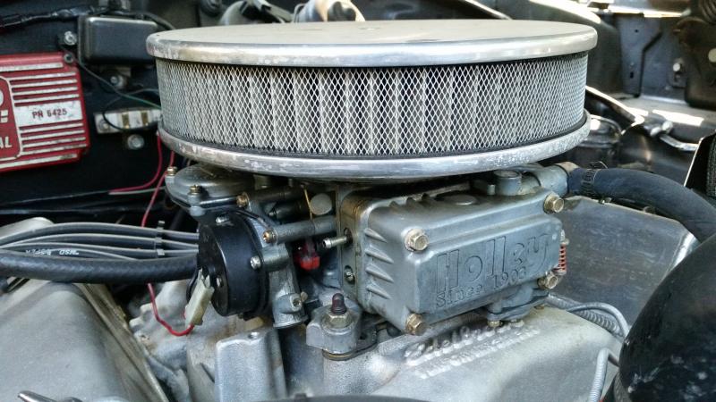

A few months back I picked up a 68 Satellite and while driving it there is serious lag off the line. 360 with Holley 4bbl, Edelbrock intake. I am not mechanical but am willing to figure this out myself. Where should I start. Feels to me like a fuel issue and sometimes it is not there (the lag). Thanks for any help guys.

Lots of variables...but I'd start with the carb and timing.
I see what you are talking about dieseldazzle. Should that be plugged or? Again I am a novice.
Its ported so its only got vacuum when the throttle blades open past the idle circuits if I remember right.
Will do. I'll let you know how it goes. Thanks!
Plugged the port just now and took it for a spin. Seemed to do well. A little to early to tell though due to the issue not happening 100% of the time. More in the 60 to 70%. I'll keep you all updated.
