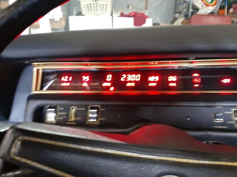

this is intellatronx dash works great
If those are 0-5v inputs they’ll work with certain systems, but most simple systems won’t have configurable input/output. If it’s CAN based, there’s a couple different languages as I understand it and limited compatibility. Here’s my setup. It’s all Holley Dominator EFI.
