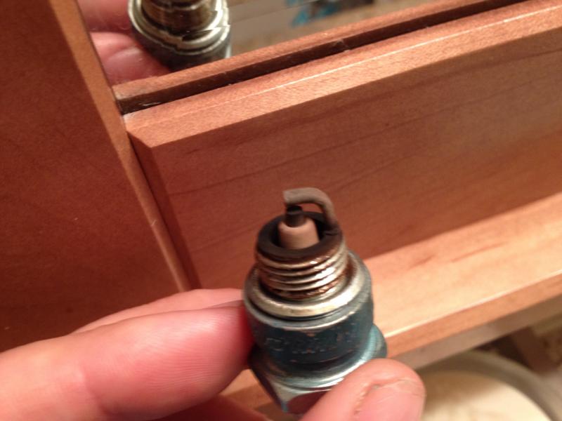

Spark plug condition after about 25-30 mils:

What do the plugs look like and what is your timing set at? Also, did you get your oil leak fixed?

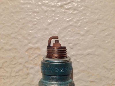

I added a pic pf the average looking plug sir:
