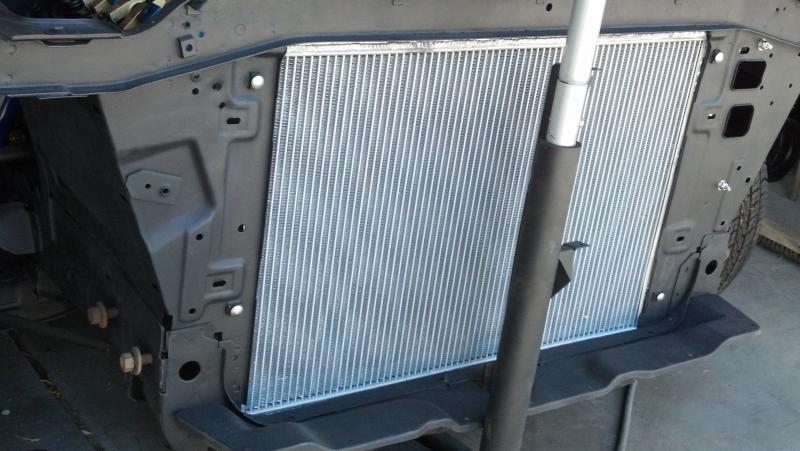

My 67 coronet has a 26" core rad from a 68 c body. Instead of a recore job, I bought a 26" core 3 row aluminum. It's a champion brand... Anybody use one of these? Any complaints?

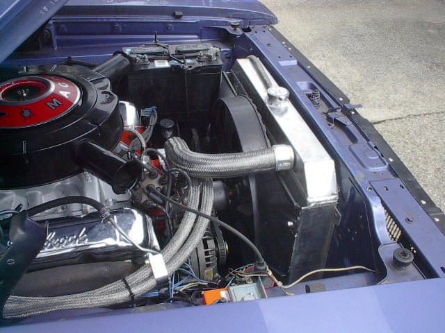

you cant beat the fit and finish for the cost on those champions.used them several times for race and street never any complaints.one for my 67 coronet fit amazing.2012-06-06_15-05-22_258.jpgi6206.jpg
Well she's in there now. Had to wallow out a couple holes in the shroud and bend some tabs on the radiator for the shroud to fit. The mounting holes in the brackets were different but I don't care. I'm not building a show car. I just used self tapping sheet metal screws. Now I have to get some Trans cooler hose to plumb into the new hose barbs in the radiator. I definitely DO NOT like the fact that they use aluminum bungs with steel nuts for the Trans cooler. I stripped the threads on one of em. Hope it doesn't leak Trans fluid. If it does I'll jb weld that nut on there.

Got a 26" 3 Core champion with a Jaguar clutch and 19" Fan, as well as a factory 26" shroud. Cools a big Ol' 512 with no issues. No leaks.
