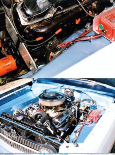

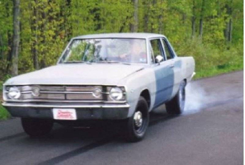

Had a 505, in this. Ran 11.60, as a, everyday, driver. --
