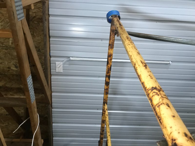

Installed one row of lights so it's not as dark to work in...
There will be 3 more rows...

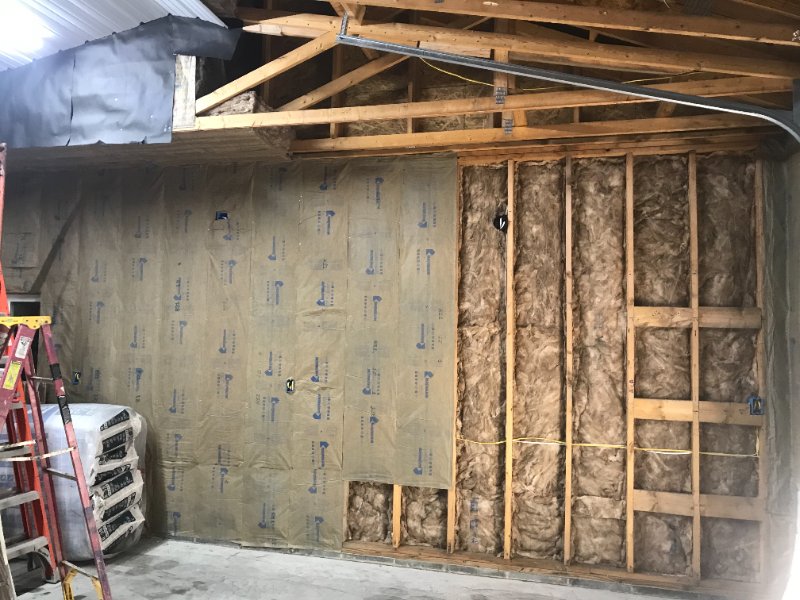

More insulation installed...
Some wiring installed for a wall mounted light/clock...

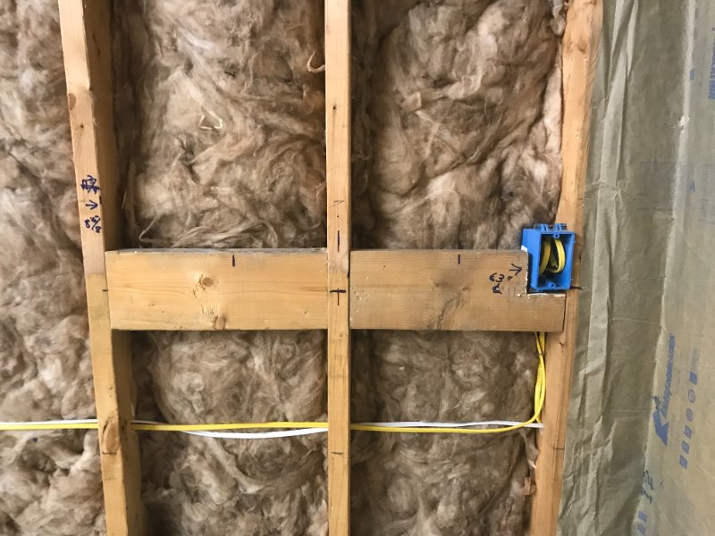

Blocking installed between studs...

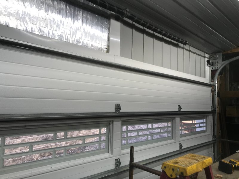

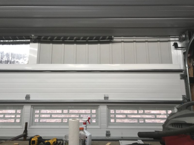

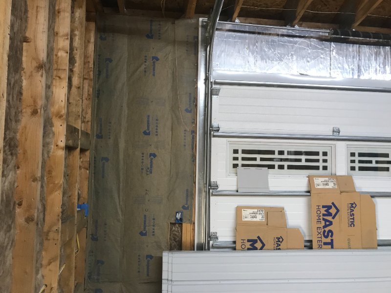

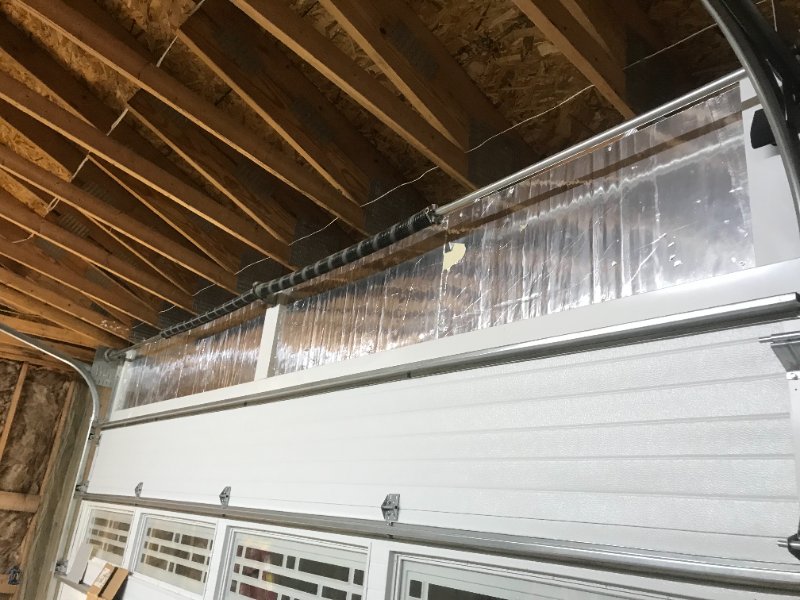

R-max finished above garage door...
It's just a slow process when installing blocking...electrical and insulation all at the same time to make sure nothing gets missed...
Got a lot of the insulation in the walls completed...

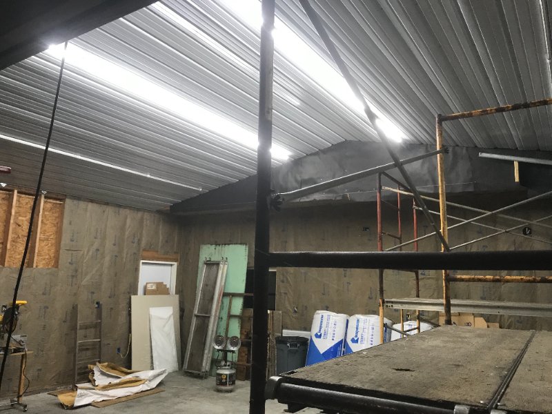

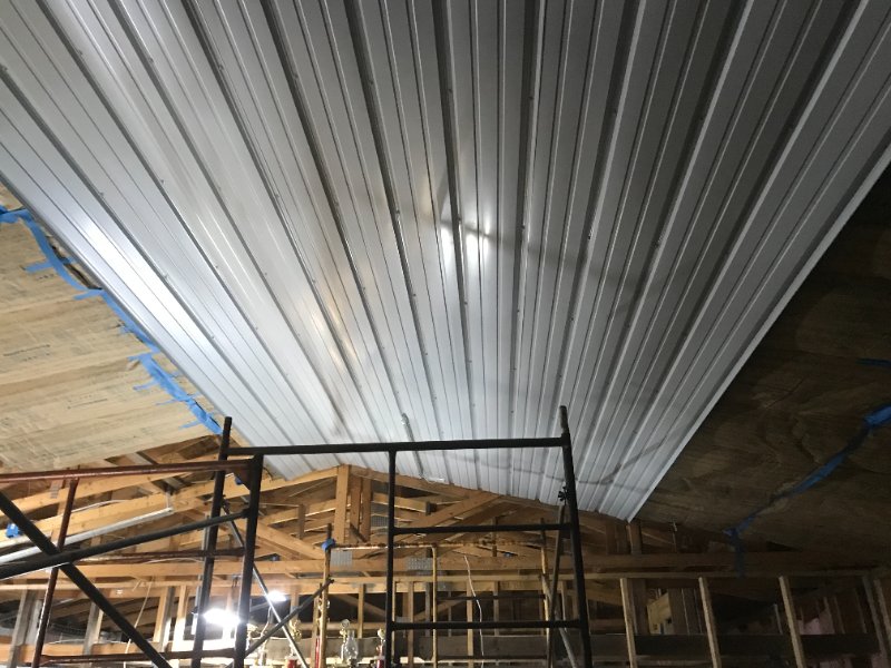

All of the insulation on the sloped ceilings is complete and all of the metal panels are installed...

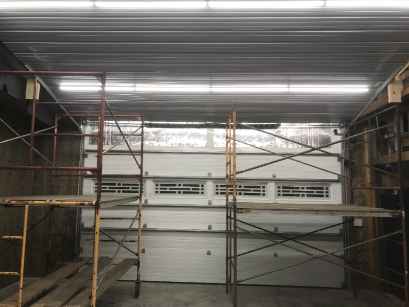

Finished up the last of the 16 lights tonight...
I'm thinking I may be using the lower or the higher lights instead of all of them at once...
I'm not going to complain about maybe too much light...

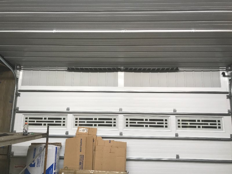

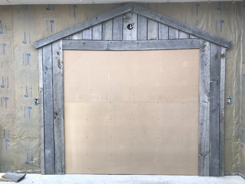

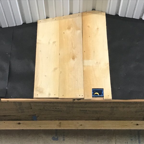

I had some of the vertical board and batten siding left over from when the front of the garage was built...
Those short pieces were perfect to put in the area above the garage doors...
One and done as this is a finished product with no additional work needed...

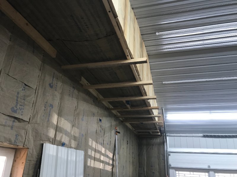

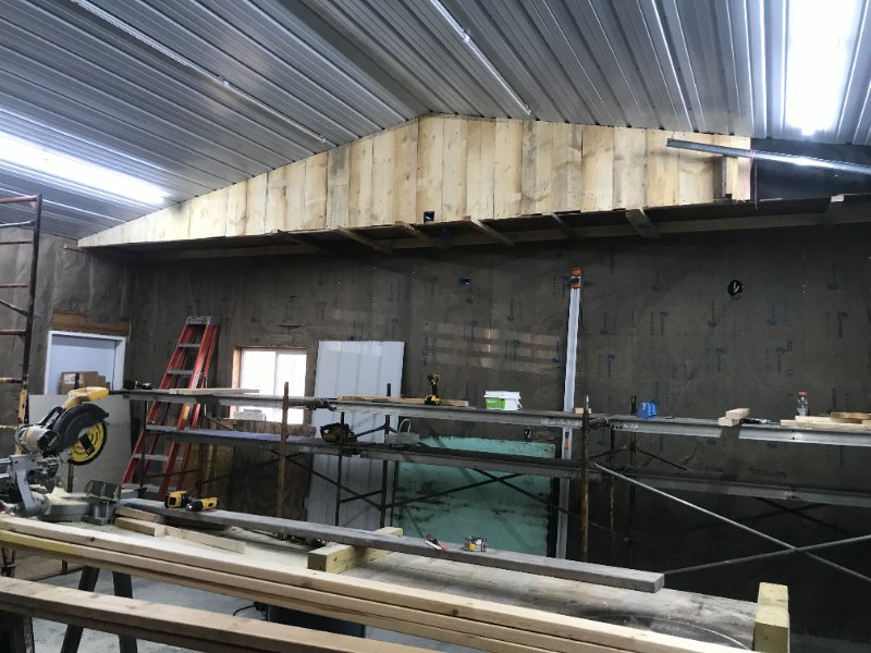

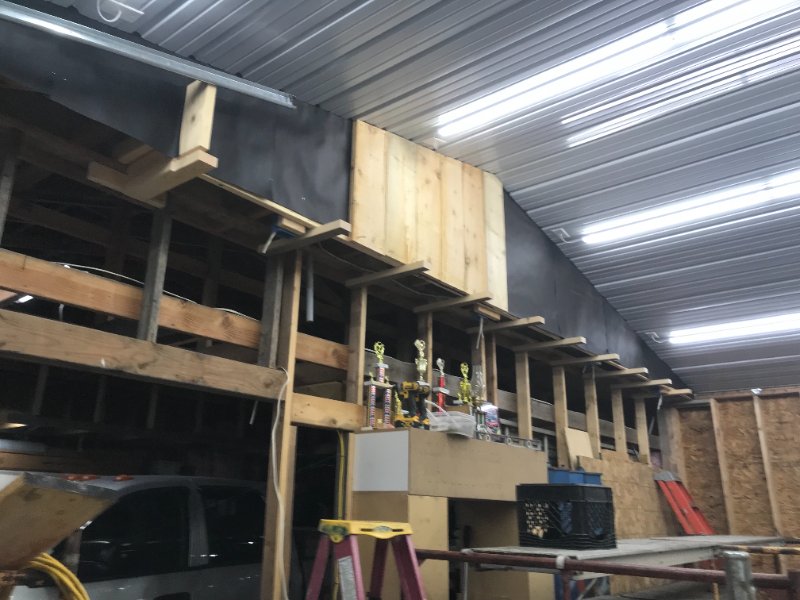

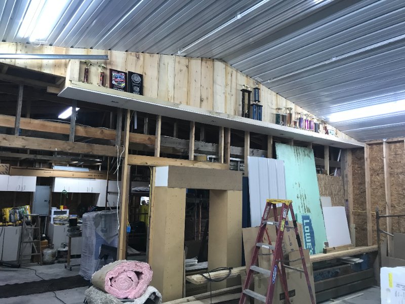

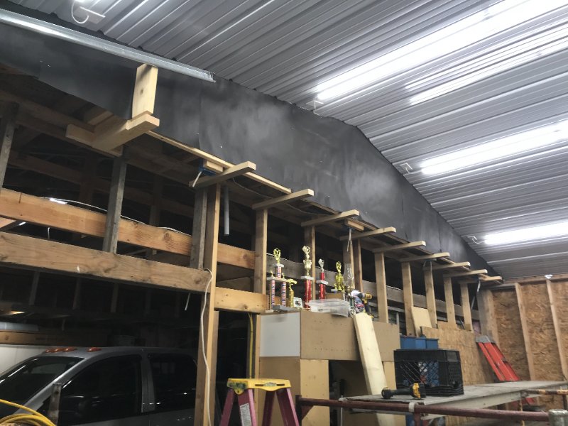

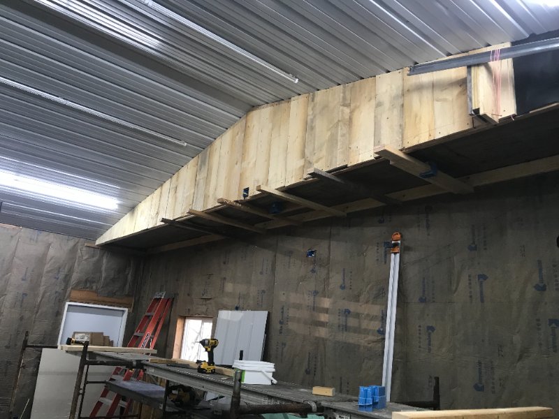

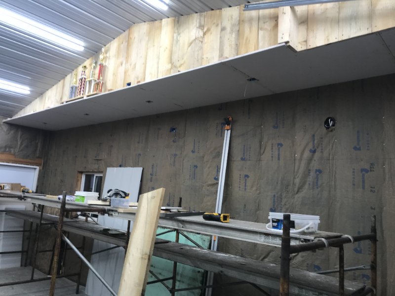

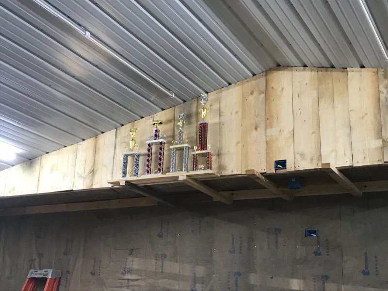

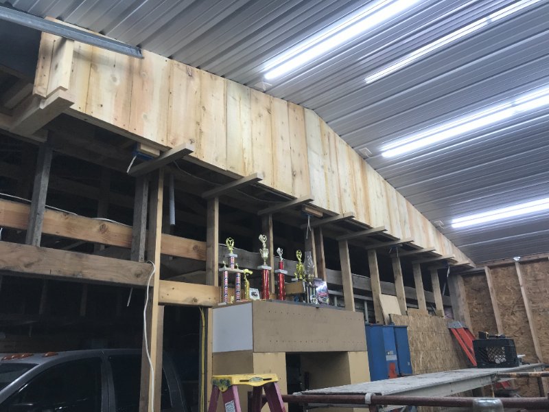

I started installing the rough cut lumber on the side of the flat bottom truss's...
There will be a drop bulkhead that creates a shelf in front of the rough cut wood...
I picked up more rough cut and finished the RH side of the truss's...

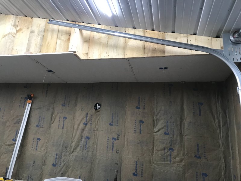

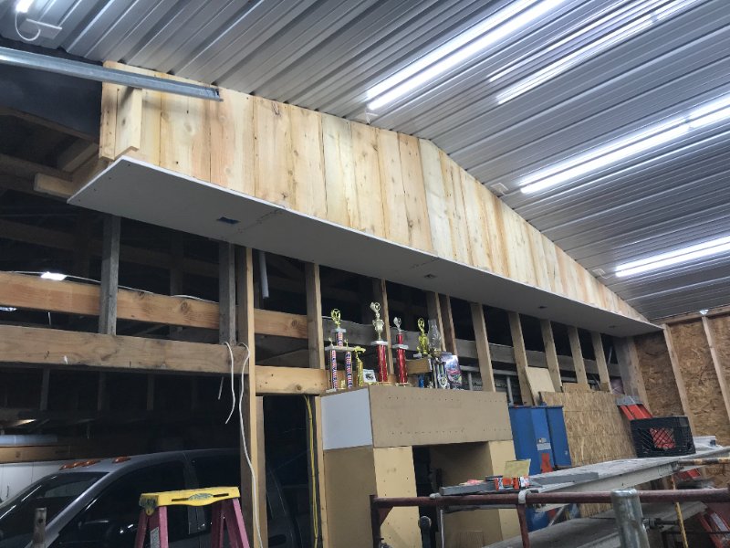

Went today and picked up 5/8" drywall and installed it on the bottom of the bulkhead...
I need a few finished 3/4" trim boards to finish the shelf and the face...

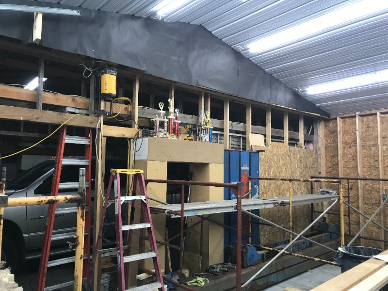

Did all I could do with what I had so I built the scaffold up on the other side and started framing the LH drop bulkhead-shelf...
14 hrs. today between chasing material and clean-up...

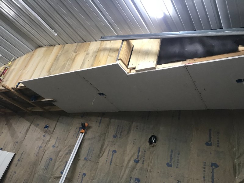

Continued framing the LH side bulkhead-shelf...
Installed almost all of the rough lumber...
Installed the balance of the electric boxes and wiring for the lights...
Hung the 5/8" drywall on the bottom of the bulkhead...

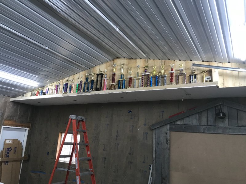

I got the wood trim and the shelves finished...but didn't take any pictures...
Moved the scaffolds to the other side so I can start on the insulation over there...
There's going to be a lot of stuff to move out of the way...

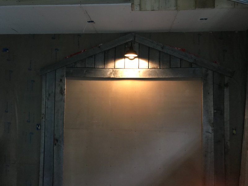

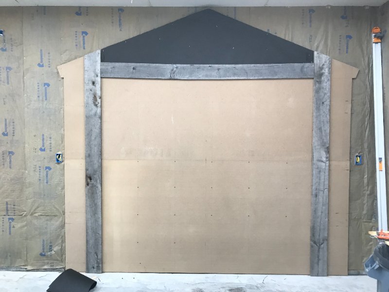

I did get the facade finished over the weekend...
I got a pretty cool 7' by 7'6" wall graphic to install once I have conditioned space...
I got pictures of the wood trim for the shelving at the top and liquidated a few boxes of trophy's from the basement...

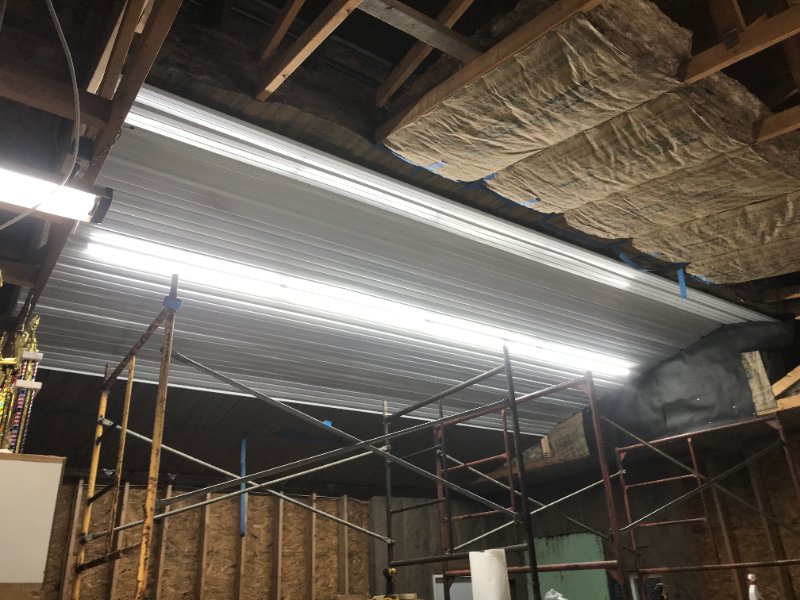

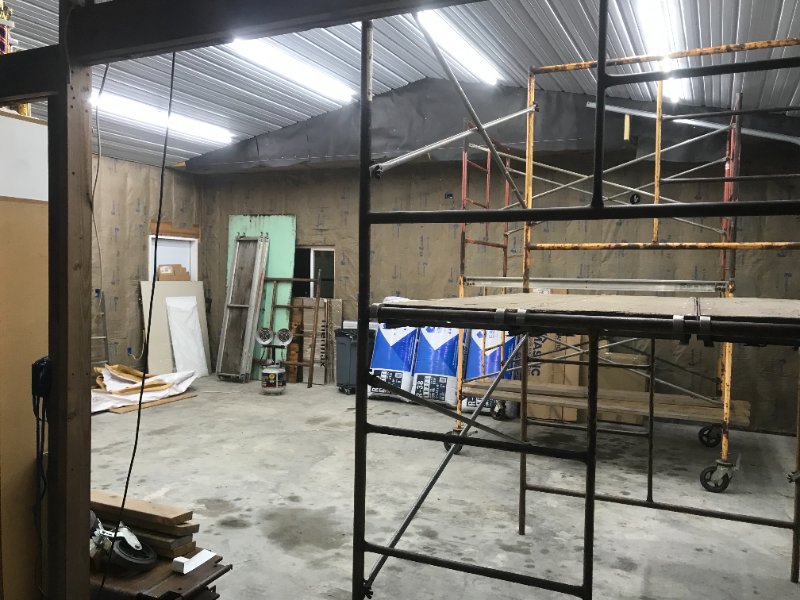

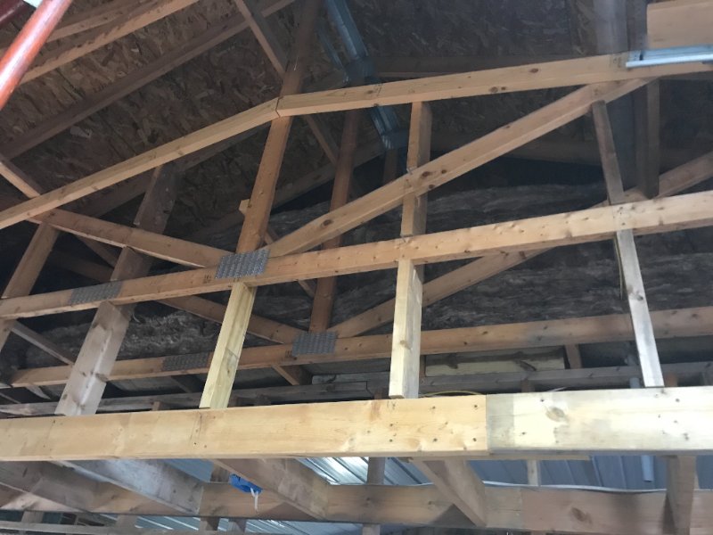

Began installing the R-38 insulation in the ceiling of the other side of the garage...
In the one picture of the side of the truss you can see how high the insulation goes as it is 1' past the bottom cord of the truss on the vertical part...

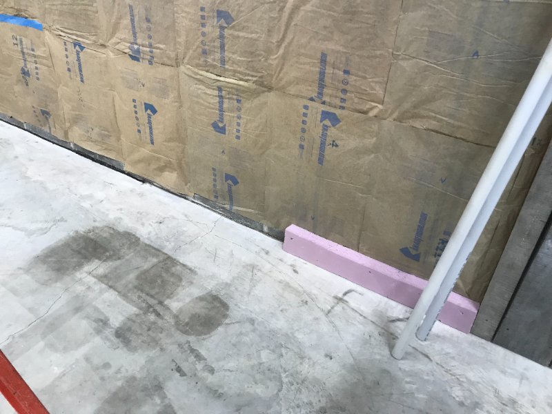

Began cleaning up the edges of the slab and installing 2" rigid insulation against the concrete block....
This will go in 4" high and be covered by custom bent steel base...

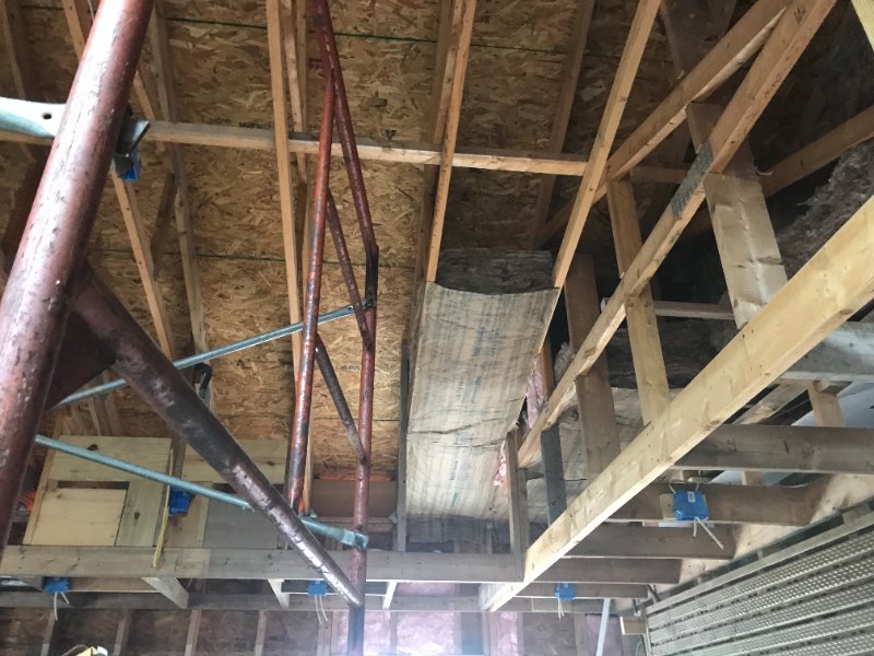

R-38 Insulation is almost buttoned up in the ceiling...
This a brutal install with having to raise and lower the scaffold planking for the higher elevations...
Ended up climbing through the bulkheads and standing inside of them to get to the top on the back side of the cathedral truss where it meets the flat bottom truss's...
Installed the R-max above the garage door typical to what was done on the other side...

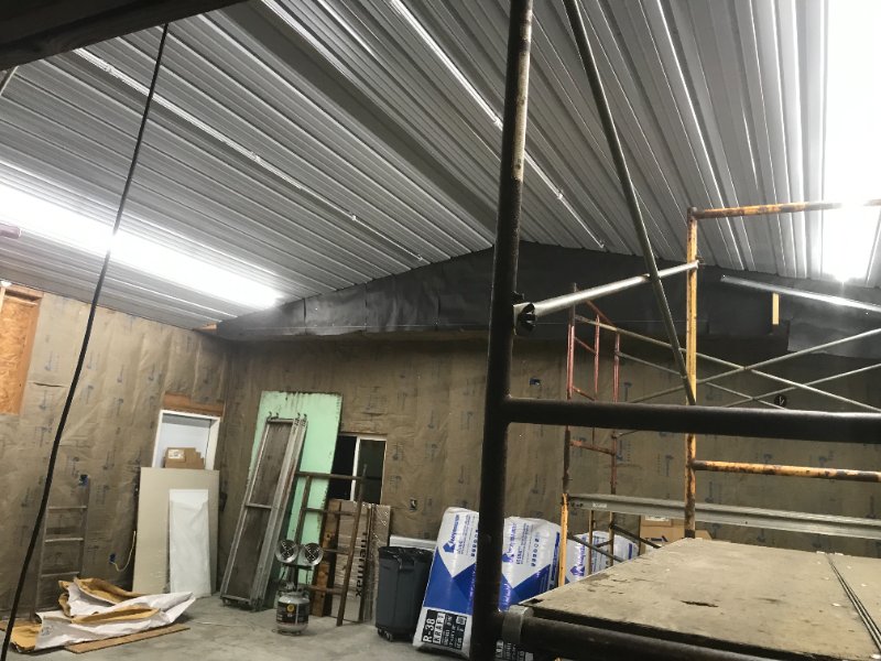

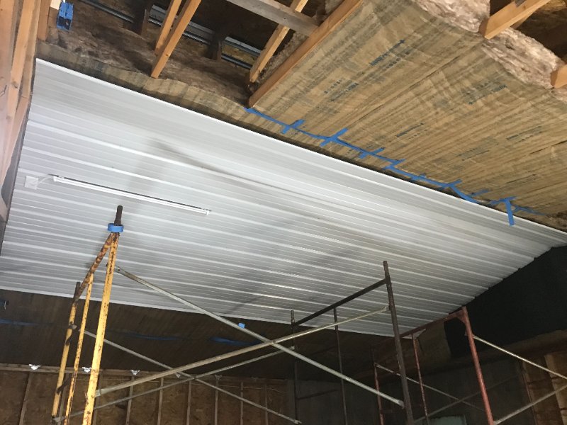

Installed all of the roofing paper in preparation for the metal panels on the ceiling...

Finished installing the metal panels on the ceiling today...
I got the lights installed and called it a day...

Started installing the rough cut lumber on the sides of the flat bottom trusses and the bulkheads...
It seems to really brighten things up...
This made it really easy to see all of the bulkhead space that was conditioned air that was not going to be utilized...
I decided to put plywood on the inside and installed a run of lights on a switch...
There are 4 entry points framed now where items can be stored...

So I ended up having 5 access points for the storage in the bulkheads...
Lighting is installed inside with a switch located above one of the access doors...
It ends up being about 60 L' of storage space in total roughly 3' wide and 18" high...
