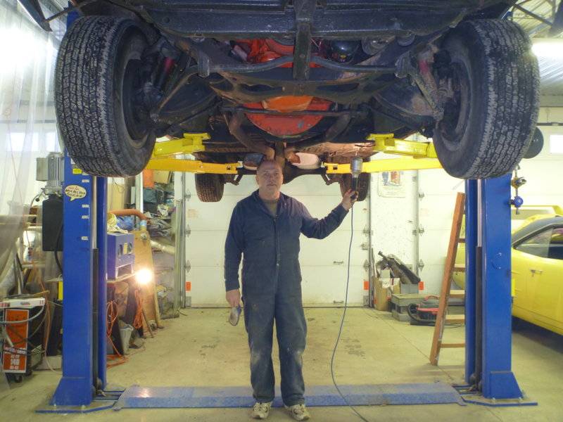

My ceiling is 10’2” and I have an old eagle 2 post lift.
I can walk under the car without hitting my head. The tires hang lower, so I’ve trained myself to avoid them.
Sure, 11’ would be nicer, but you can absolutely effectively use a 2 post lift with a 10’ ceiling.

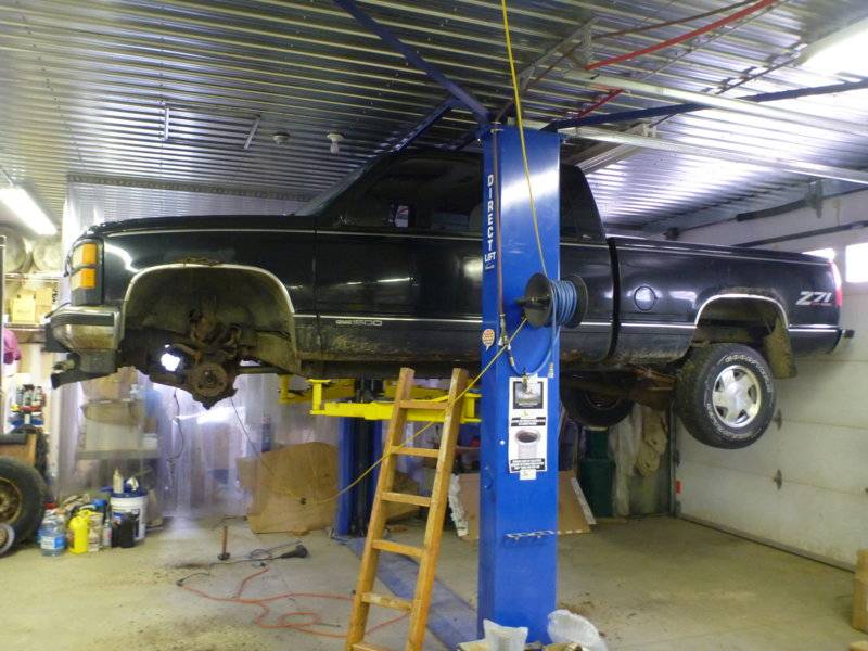

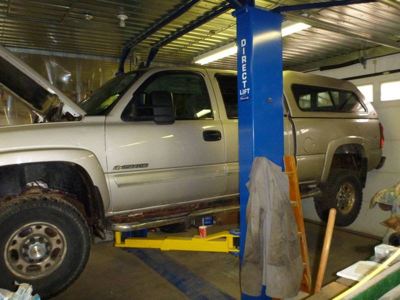

Of course working on our low cars gives lots of work room with a 10'2" ceiling. Move on to modern cars or a truck and you'll be bending or better yet rolling around on a work chair if you need to get underneath. That said I have no complaints after over 1000 hours of work time on my hoist, even with trucks it's perfect for most work that's usually replacing these modern, useless, 2 bearings an inch apart, unable to take torsion load, designer should have been shot, hubs.
