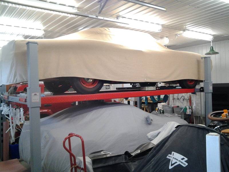

    I have 10'6"and have 2 B bodys with a 4 post lift with a trolley jack and yes 11' or higher would be better but I have 4" of clearance to the ceiling and can do everything I need to do. 20170526_223045.jpg

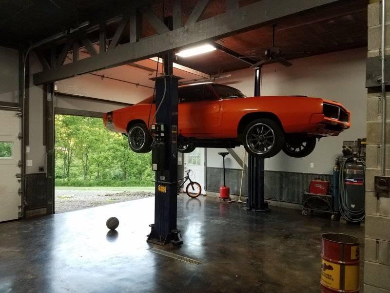

          I bought a Worth for the garage I just built, looking at most it seams way heavier with a larger footprint (24") and is made in Texas. So far no complaints, I've had a Dodge Mega Cab Cummins Diesel on it along with many others but that's the biggest. Seams well built, simple to install and easy to use with a nice lift speed.

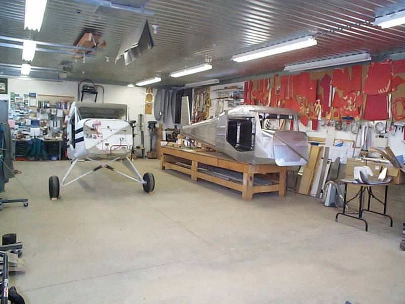

                        Same as mine Mark, I'd never do a ceiling any other way again. Did our plastic plant production floors ceiling with it in '89 and carried that idea home with me to the shop. The light level is amazing. Galvanized steel roofing...
