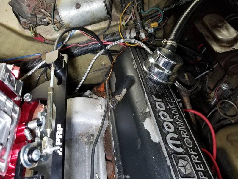

Prp racing throttle cable is what I used. It bolts directly to the carburetor studs, then a factory style throttle cable from Rick Erenberg. 24.5 inch long cable and you're set.

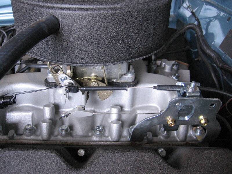

Got this one from Indy. Mancini sells them too.
This one is for a 440 but also works on a Hemi single 4 bbl.Adjustable.
