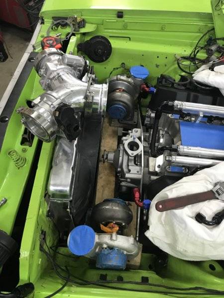

I don’t have any experience with the Silversport products. I have a built 727 behind my hemi. It’s probably gonna be tested this time around.
Yeah the twins are gonna give the old girl a run for her money.
