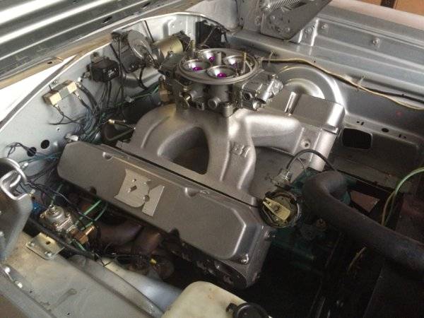

But with the B1 heads the engine is just so damn tall!!
I mocked it up tonight..

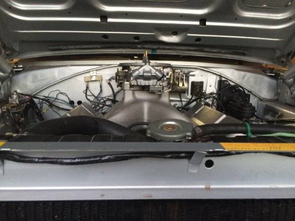

Doesn't look like that hood will close even without an air cleaner. What's the plan for that or is there a scoop on the hood now?
Here's what I'm dealing with.
RB block / Victor heads / Super Victor intake, 1/2" wood spacer, dominator and flat base plate.
I'm installing an engine plate and that will give me 3/8" more space but I'd like the option to run an air filter as well. The gravel and crap that blows across my regular track at times will wear out an engine in no time.

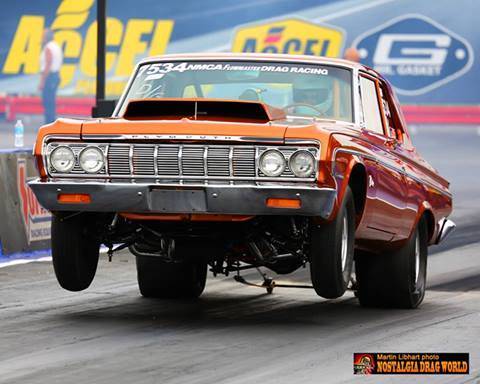

To me a properly built motor doesn't need dyno time. Testing different cams, heads, then yes. Also lots of places to remove weight. My 64 is 3145lbs w/o driver. That's with a 270lb Mega block, 2 batteries, 2 fans, 2 carbs, fire system, all steel including bumpers except hood, full interior except rear seat, old school Americans, Dana 60.
Doug
