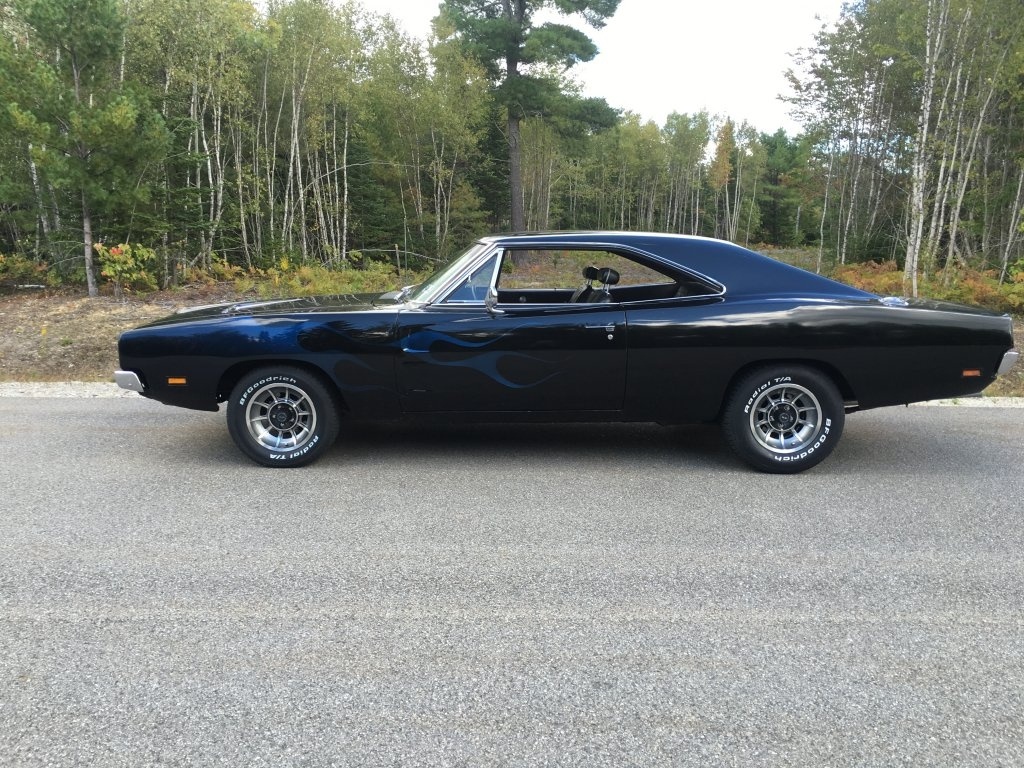

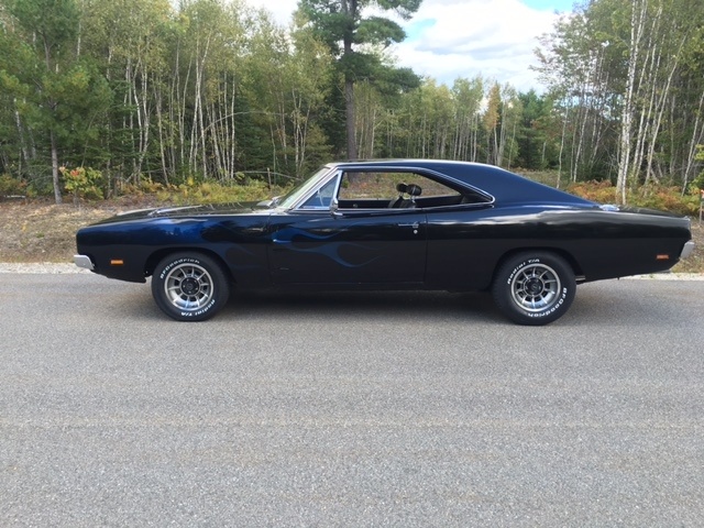

Just got them on!! Much better than the 17" that came with the car. Always liked the vectors even though car will not orange! Definitely not judging the orange ones with vectors too.
When I get home, I'll post sizes of wheels and tires so it'll be out here. I know I struggled to find a definite short answer for sizes etc.
Wheels, tires, stance. Got it nailed. Lookin good. Those wheels look great on a black car. Post before and after along with sizes.

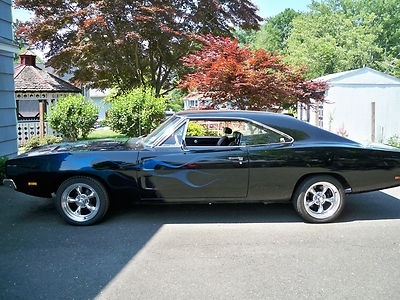

Before
after
Thanks! I like it a ton better! Here's the specs on what I have...
VN47 vector wheels bolt patter: 5x114.30 (typical Mopar)
Front - 15x7 zero offset / 4" backspacing
Back - 15x8.5. 6 offset / 4.99" backspacing
Tires: BF Goodrich radial t/a
Front - 235 60x15
Back - 275 60x15
Fit perfectly! No spacers etc.
Hopefully this info will help some figure things out faster than I did!
Did have to move the proportioning valve as knob was very close when cut wheel hard to left. But everything else fit great.
Here's before and after pics. Unfortunately not same pic set up...
