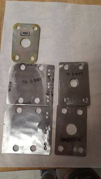

Front and rear torque boxes and EDIT: I ordered the AR racing reinforcement plates from Mancini, so just these, not "inner and outer".
The subframe connectors are due at the shop any day now.
That should take care of my immediate reinforcement needs, right? Did I miss anything critical?
Wes at Mancini said I should be good to go, and the AR reinforcement plates work with the factory hardware.

Inner plates should be fine, l would not weld those in. I would do a little welding on the backside to reinforce the spotwelds. Factory plates are thinner than the ar...but together are thicker.
The AR plate goes under the nuts for the 4 bolts OR on the other side by removing the spring hanger, holding the plate there w/my fingers, and the 4 bolts then hold it in place? I'm thinking that plate goes on the nut side?
And they were not welded on the factory cars that I have taken apart.
The factory front plate is welded thru the big center round hole, only tack welds to hold in place. The rear plate is absolutely welded. Front would be fine with no weld, and I would not weld it. If you want to weld it put it in the back that way it is easy to remove.
The smart thing to do is use you ar plates for a pattern and make a rear plate out of .125 and full weld it to the frame rail and spring box.
I agree if you are eventually going toward the 700HP range.
On the V code 70 that I did the plates on the spring hanger side were welded and were never taken off, but the plates on the nut side were not welded.

Mancini already shipped the AR plates, and my mechanic said if the spring hanger studs are too short he will replace them with grade 8 bolts no problem!

He is fine with having to add the spring plates, no problem.
I'm going to get the rear (outer) (spring hanger side) "square" plates from Classic Industries because I'm having trouble finding them elsewhere, and if the AR inner (front) plate plus the factory plate on the other side is too thick, he will replace the studs with bolts.
After talking with him about replacing the spring hanger bolts, I decided to just get the factory inner plates, and use the thicker AR outer plates that are already on the way. He said absolutely no problem if the factory studs aren't long enough, he will replace them with grade 8 bolts.
