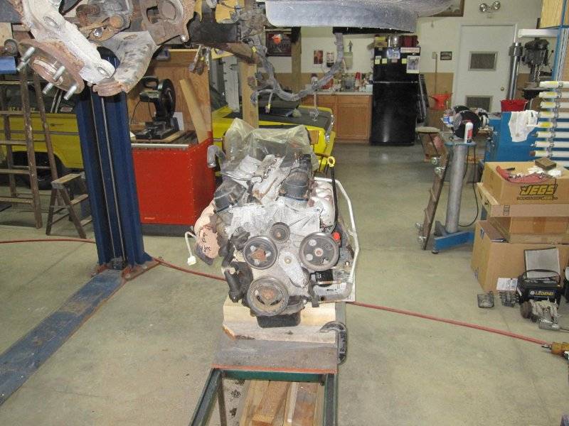

Ok. I just finished pulling the 3.8 out of the 2008 Chrysler T&C I purchased as my new winter beater. Until you perform this job from hell do not ever complain about dropping the drive train out of a real car.

Those aren't too bad. At least with chryslers you can reach into most areas.

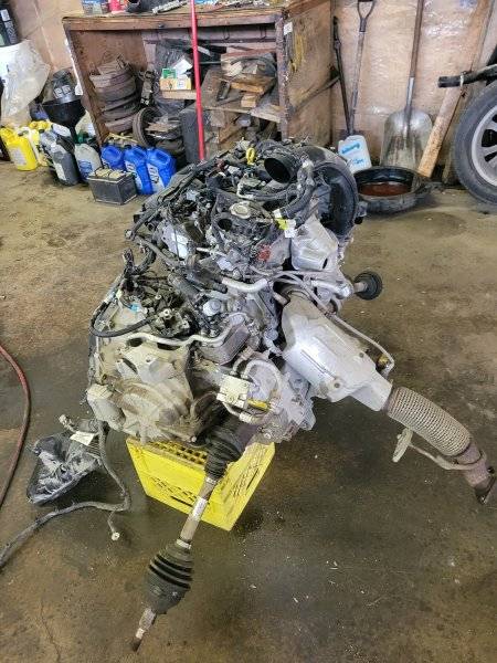

*STAY AWAY FROM THE TURBO FORD PIECES OF *****
You haven't lived until you pull a AWD Drivetrain out the bottom. At home. At least I have a hoist. And then realize the motor spit a rod behind the starter where you couldn't see. Crank won't turn. The motor won't slide far enough forward for the converter to come out of the transmission. It cant tilt up far enough for the oil pan to clear the cradle. The cradle setting on jack stands and have it ratchet strapped to the car on the hoist. The cradle falls off the jack stands and finally it comes apart. The you torch off the flex plate around the bolts to save the converter. Then set the cradle back up on 6x6 and plumb bob the bolt holes so its close when it's lowered back down. With yu wife running the hoist you pry bar the cradle into position and bolt it back in.
