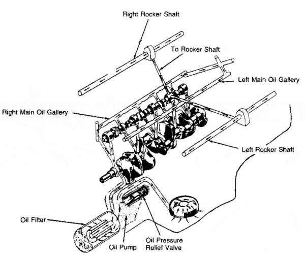

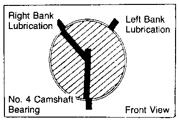

Keep in mind, both of those oil gauge ports are fed via the main rocker arm oil galleys. Because of the design, the oil ports that feed the two rocker arm galleys, work off the cam oil ports. Depending on who built the motor, and parts used, it takes rotating the motor by hand (half rotation, or so) to feed oil to BOTH sides of those main oil galleys, and to both oil gauge ports.

Here's the flow diagram. Second pic is the cam journal oil ports for the rockers.

Maybe I'm wrong but I believe, if you look at the diagram, oil runs up over the #1 main into the right main block gallery. At the rear, I believe, the gauge port is shown but not labeled. That port, if open, should flow freely unless there is another path of least resistance, or it's restricted, or pump fail.
