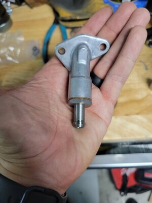

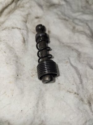

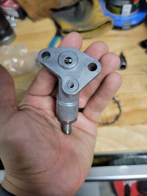

It sounds like you may have a jamming pressure release valve in the pump.
Is this the pressure relief valve?

No I don't think so.
I am no expert but I think it is at the back of the pump housing.
The Saginaw pump uses a combination flow control valve/high pressure relief valve. This valve performed two different functions. The flow control valve regulates the pump's oil flow to prevent overheating the oil under normal circumstances. The high pressure relief valve determines the maximum pressure the pump produces, typically 1500 psi with the wheels against the travel stops as in parking maneuvers. IMO, it is highly likely that the flow control valve is causing your difficulties. It is located INSIDE the pump housing, mear the outlet fitting connection. The FSM will show the exact location. Depending on the engine and final gear ratio, if the final gear ratio was 3.54:1 or greater, a oil to air heat exchanger was installed on the steering box to pump's return line as part of the the pump's mounting bracket. Just my opinion of course.....

Thanks guys for the quick responses. I am going to change it out, replace it and see what happens. This plunger with spring was pretty much jammed in there. I would imagine it shouldn't be so difficult to remove.
