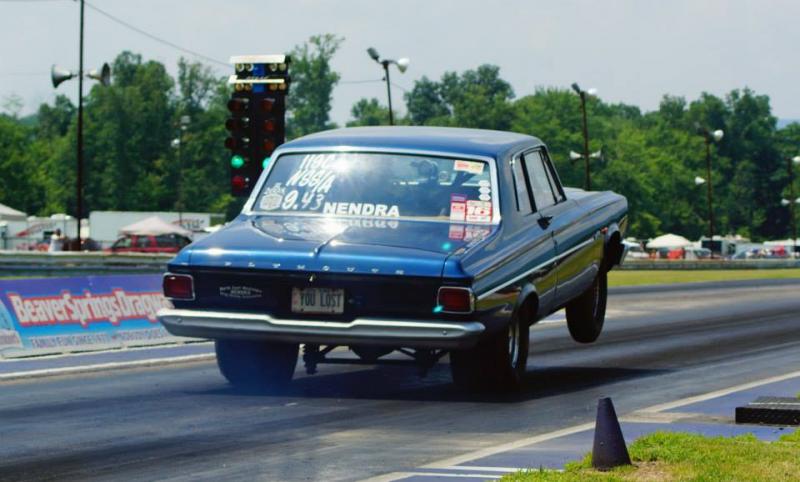

There is an association called East Coast Gassers in our area. Beaver Springs has a nostalgia race that we all go to every year in july that you would love.

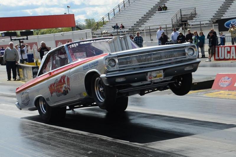

Thanx . 4 ur input . . The 422 allstars nss . Have a awb class 10.50 and faster. Mabe i can run a race here&there without run'n all cross country, i just dont want 2 b in a 200 car field with a car that's put 2gether for a nss class . The deal at the springs , the p.i.d. At pitts. R in may range., mabe i can fit in2 whatever bob george puts 2gether. What part of the world does dave collett put his races up ?
Dave is in Md and he has run his races at Cecil County dragway and Maryland International Raceway both in Md so far. He goes by his own rules as he is not to tuff with his rules and lets some cars run that cant run in other NSS clubs. He has nice 64 Plymouth Hemi car and he just bought a real SS/AH car. At his last race he let the first 24 cars signed up get in the track for free and if you made the first round call he gave you $100 dollars. It cost me $50 dollars to run his race but I got in for free and got the $100 dollars for making the first round. Did not matter if you won or lost the first round he still gave you the money. So I made $50 dollars just to run the first round at the race. I will dig up a pic of his car and you can call him as he owns Collette's towing and trucking company here in Md as it right near Cecil County Md. My brother knows him real good. He had his 64 for sale as he also had a 68 Cuda bracket car and he sold that Cuda and bought the SS/AH Cuda so he may be keeping the 64 now. His 64 was on "Cars On Line" for sale and I believe its still on there but I think he plans to keep the 64 now. Ron
Here is Dave's nice 64 Hemi car. I can get his phone # from my brother tomorrow for you if you like. My brother Gary Nies knows him real good as he races with him alot. Just let me know if you want his phone # if you want to talk right to Dave. Ron
This is from NMCA NSS rule book. FX Class allows any period correct wheelbase altercation. However the front suspension doesn't say anything about allowing straight axles. I would say call NMCA to see what they say. I know that 422 Motorsports allows AWB cars to run NSS... at least at the Beaver Springs race they do.

Notice the decal on Clays windshield. Required to run in NMCA. Thats also a NMCA#
