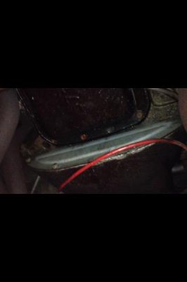

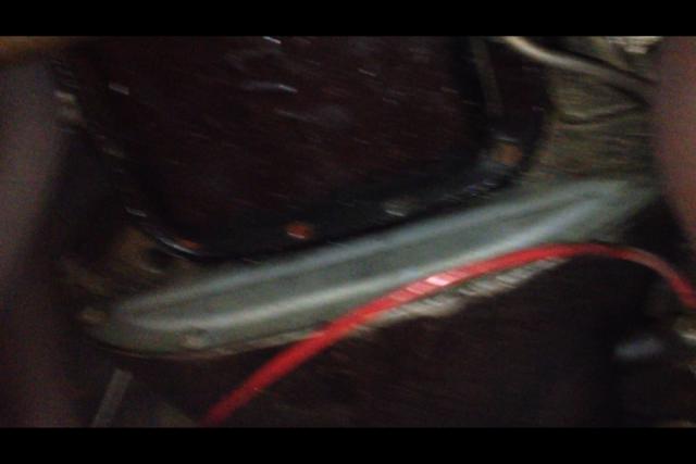

I have a 70 RR and there was a rattling noise which i discovered is inside trans at idle only. took fly wheel cover off and found a nut 5/16th or 1/4 at bottom of housing. any ideas where nut goes before I drop trans? I herd it might be in torque converter.
took silver plate off and found nut in bottom. if u PM me your email address i can send u video of sound. i added picture of trans.

Other than the TQ bolts and the screws that hold the inspection cover on and the bolts that hold the shaft seal in place, there are no other items that have a connection. Sounds like who ever did the last service left it in there.

Sounds to me like it was something that got left in the bellhousing area on assembly. There are no nuts the size you describe in the bellhousing area on anything.......of course that's just a guess since the offending nut has yet to be seen.
Seems like someone may have left a nut in there somehow the last time it was worked on. There is nothing that size except the bolts that hold the inspection cover on.

You don't have to pull the trans- remove the inspection cover and fish the nut out. Rotate the engine with the crank bolt (disconnect battery) and make sure all the convertor bolts are there and tight. Reinstall cover and drive it like you sytole it!
