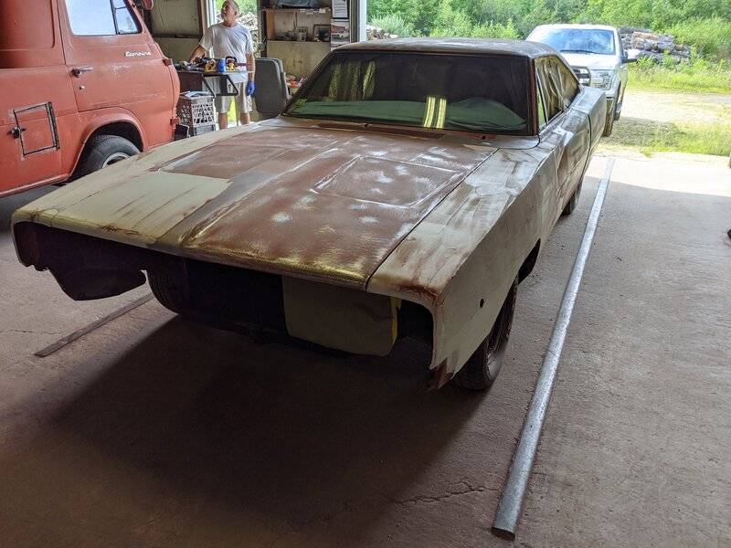

Off to the body & paint shop today

Mine's about the same color and faded....not sure if I will try anything on it....want to be driving and not worrying when it's parked somewhere besides my driveway !
Yep sure looked good to me. But that is what pic's do for you. To see it in person may be different. Good luck with the paint. :thumbsup:

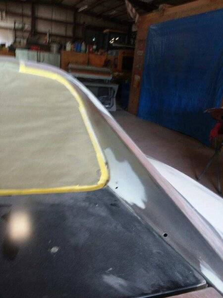

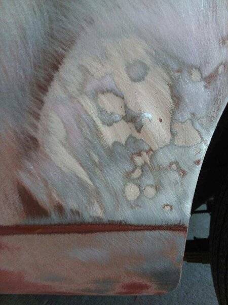

That looks like Polyester glazing putty on there. He is just using it to fill minor imperfections, most of it will end up on the floor. It's just to get the panels perfectly straight.

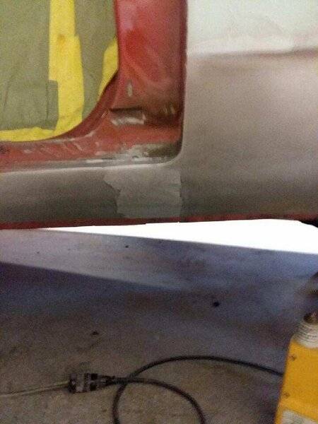

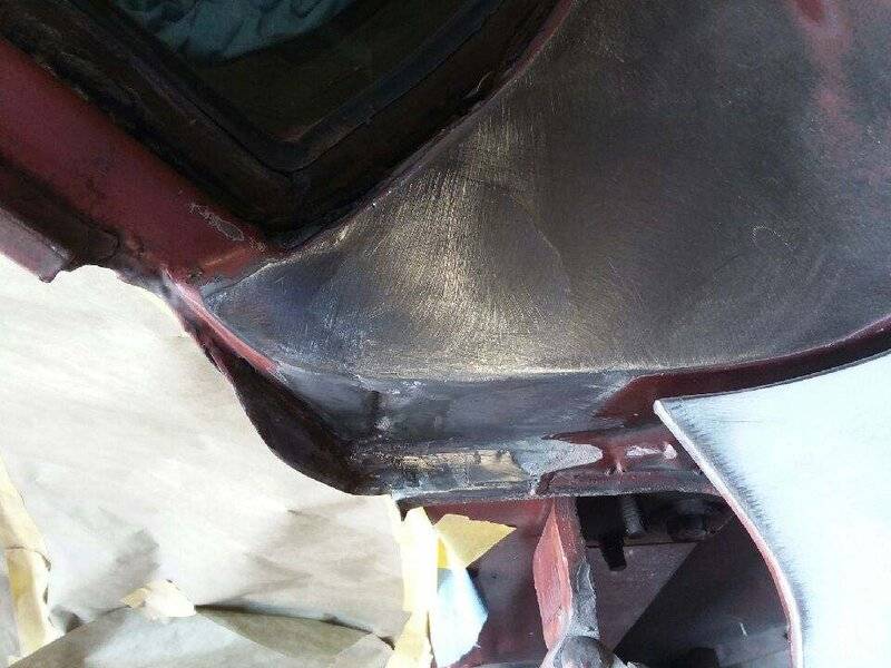

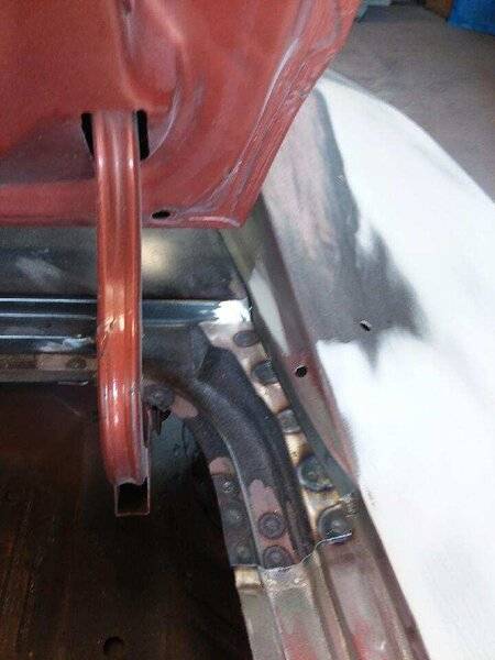

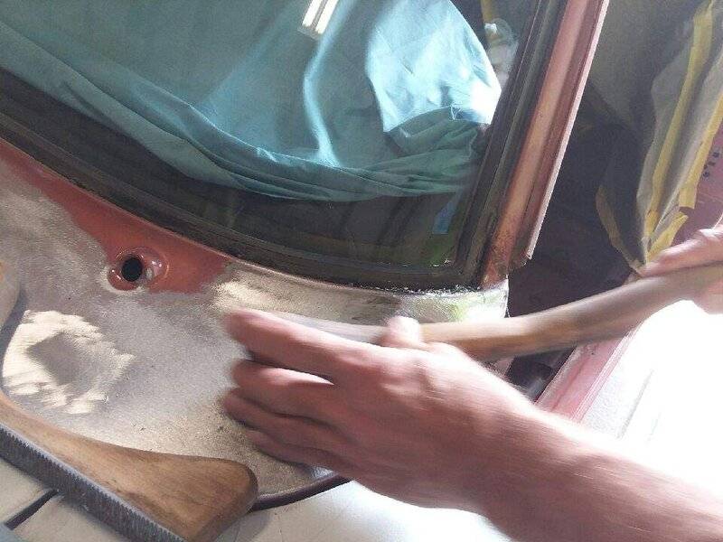

Some updates. Because the rear window channel had some nasty rot/rust that was poorly fixed, a replacement dutchman panel was installed...
Lead work repair on the cowl & rockers....

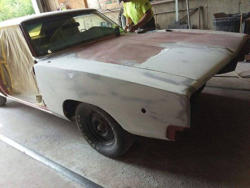

Always scary when the paint comes off! Looks like they have it well in hand Mark! When do they pull the glass and interior.. LOL

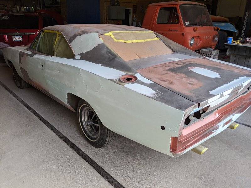

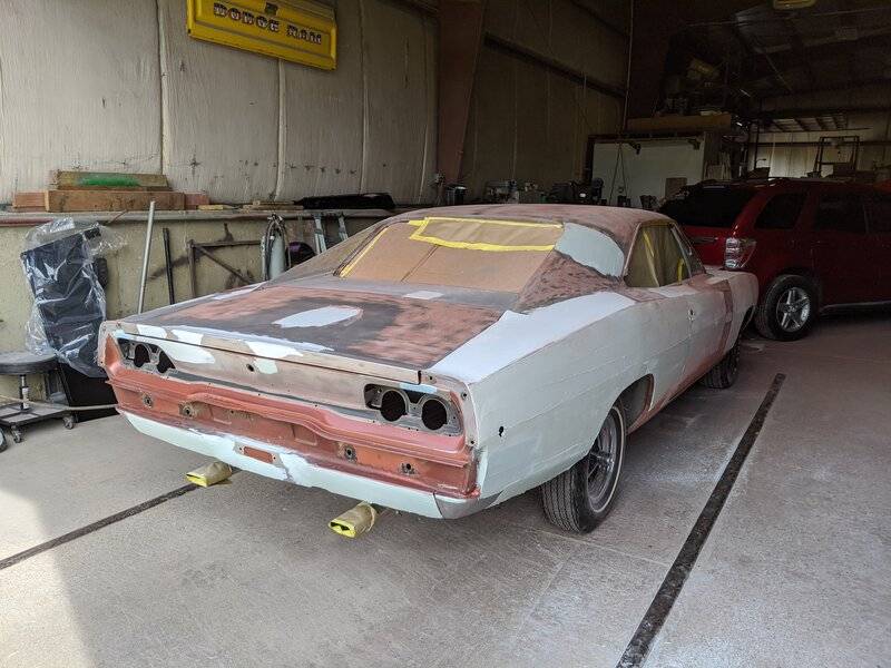

That is true. This previous damage in front of the LR wheel opening had about 1/2" of bondo in it. That was the worst hit that the car has taken, which isn't bad. The bad metal was cut out and new metal welded in.
Even though the car wore most of its original paint (LF fender & LR quarter repainted), there were enough dings, scrapes & buffed-too-thin paint that bothered me. I'm glad that I've gone this route.
