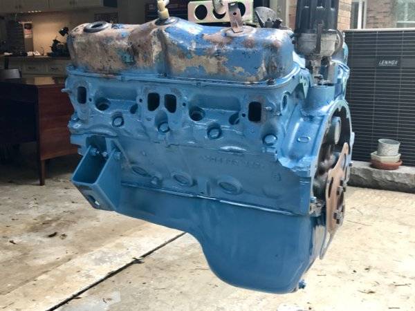

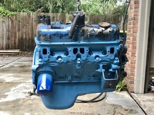

I swapped my 318 for this 360 4 months ago. The 360 is a crate engine with approx 20k miles and was in a ‘78 Karry van. I replaced the timing chain, water pump, intake and carb, and also had to buy a car pan because the 360 had the rear sump truck pan (see photos). I also took off the pump and added the correct pickup tube.

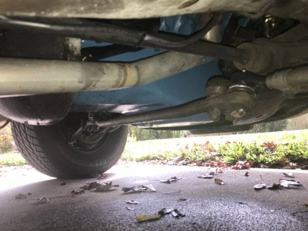

Question. This is a ‘70 Belvedere. Nothing seems to be in the way of removing the pan but the steering linkage. Will the pan come off without removing the linkage? Looks like the rear pan notch “could” pass over the oil pump and remove the pan forward? I know I’m reaching but figured I’d ask anyway.
Drop the center link...makes life a whole lot easier.
I've never been into a small block, but parts is parts. Pan needs to clear the crank counter-weights, besides the pick-up tube.

View attachment 554227 Question. This is a ‘70 Belvedere. Nothing seems to be in the way of removing the pan but the steering linkage. Will the pan come off without removing the linkage? Looks like the rear pan notch “could” pass over the oil pump and remove the pan forward? I know I’m reaching but figured I’d ask anyway.
Agreed with miller, the center link has to come out tand make your life easier. Besides, it has to clear the pickup.

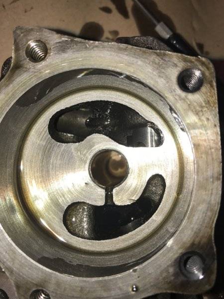

Finally pulled the pan. Oil pump not loose, not cracked. I can’t get the plug out that caps the relief valve, but I can move the piston freely with a pick. Does it look to be in the proper position in the picture? There was about a dime size pile of debris in the center of the pickup tube screen. Mostly rubber particles. I’m replacing the pump regardless. What is my next move? Install new pump and try it?
That rubber debris could have easily been the problem. Again, I don't have experience with SBs, so don't know rubber locations. O-ring installed wrong? Anyway, yeah, a different pump, or...rebuild the one you have, with new seals, if the clearances are good. With the trash in there, easy to have some in the relief valve seat...knocking the oil pressure down. I'd get the valve out, for a look.
At least your not looking at loose metal!
The bits of rubber are most likely pieces of old valve stem seals. There are no o-rings or seals in a pump. I don't see anything there that would leave me to believe you have found your problem. I wouldn't be putting the pan back without looking at the mains and rod brgs.
