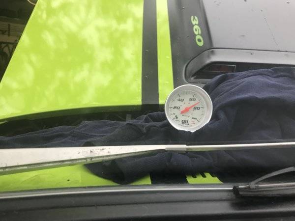

SUCCESS!!! After 4 nights of pain and suffering in the cold, on a wet driveway, under the car, I removed the drag link and oil pan, I cleaned the pickup tube and replaced the oil pump. Cranked it up this morning and behold the sweet oil pressure! All those noises are all gone. Thanks for all the advice. Now on to that leaking power steering gearbox ugh!
Hello Sonny, I was reading your thread since I have a similar low oil pressure issue. Question, what brand pump did you install? was it high volume or stock? thanks Chris
View attachment 559578 SUCCESS!!! After 4 nights of pain and suffering in the cold, on a wet driveway, under the car, I removed the drag link and oil pan, I cleaned the pickup tube and replaced the oil pump. Cranked it up this morning and behold the sweet oil pressure! All those noises are all gone. Thanks for all the advice. Now on to that leaking power steering gearbox ugh!
