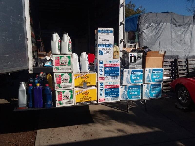

I just use whatever I find in the garage. I tend to buy oil when it's on sale, whether I need it or not.....
