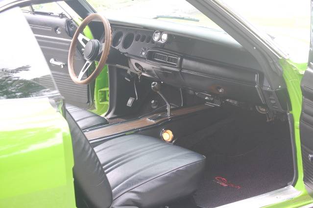

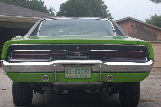

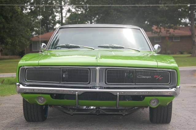

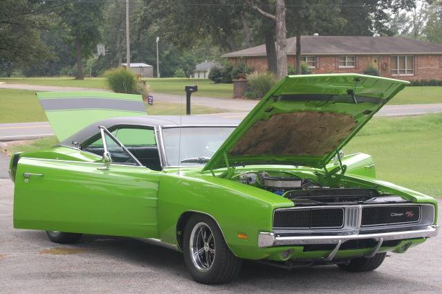

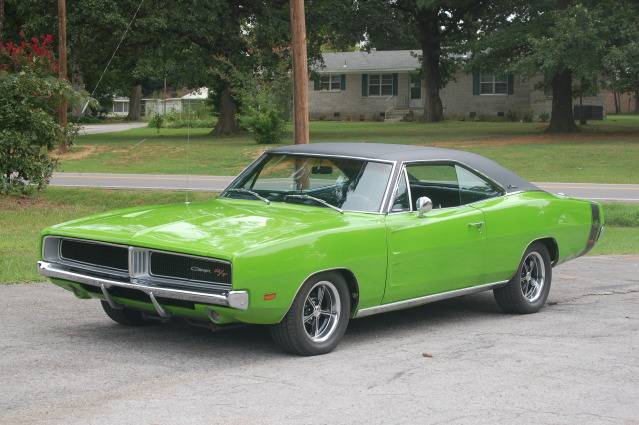

Hey guys, over the last couple of months I have been working a lot of overtime, had a couple deaths in the family (my aunt, and my wife's grandfather), and my Mom has had surgery. That's why I haven't been around much, and my charger has been sitting since the 'accident'. Well finally last week I got back on it, I was able to wet sand then buff all the scratches out, changed the power steering gear and got my steering back together. I haven't replaced the stripe yet, really you can only see the scratches when the light hits it just right, so I'm not in a hurry to do that (maybe a winter project). Today was a beautiful day so I took the chance to clean it up, was pretty dusty just sitting up in the shop for a couple of months. Took some pics when I got done, thought I would share a few, and let everyone know it all buffed out good *:2thumbs:
