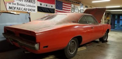

Operation: My new Hemi Charger 500, 5th one built of initial 6.
1969daytona
2:18 PM
Aug 2, 2011
188
351
Cypress, Texas

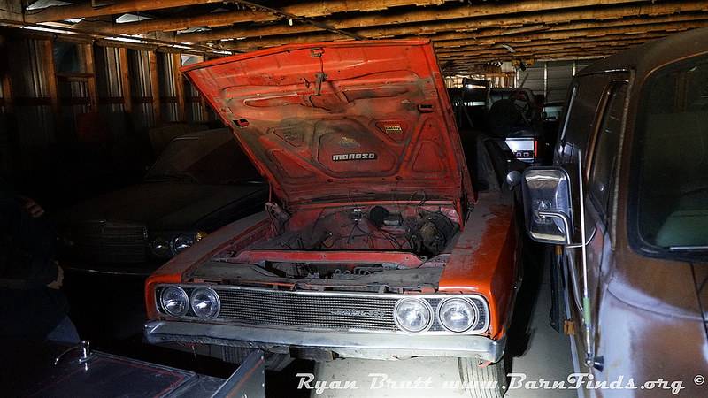

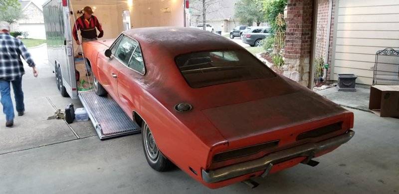

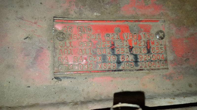

Operation #4; well, the day has come.. My 4th 1969 Dodge Charger 500 is actually Charger 500 #5 built, one of the original pilot group of 6 designated for Press Release. Luckily she survives with her original 426 Hemi. As you can see from the fender tag, the VON is 925004.. 500 VON's always start 925xxx.. This car is 925004..
It has been told that 3 of the first were 4speeds and 1 auto known (mine).. Two unknown.. It is highly likely mine is this 500 in Bud Lindermann's road test on the new Dodge Charger 500..
<<< Road Test video
Want to give special thanks to Tom, previous owner for over 30+ years, Daniel Liebrandt for connecting us and Dave Points for his assistance on this trip. Kim Cook Hawkes, honey, guess I'll be in the garage if you're looking for me..

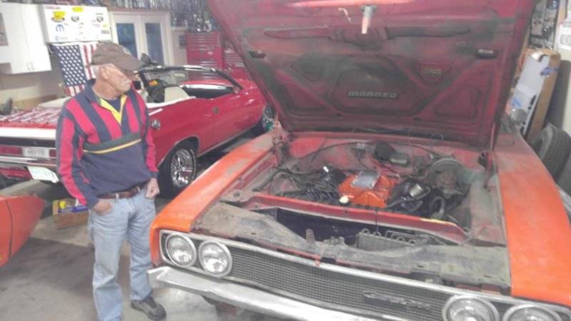

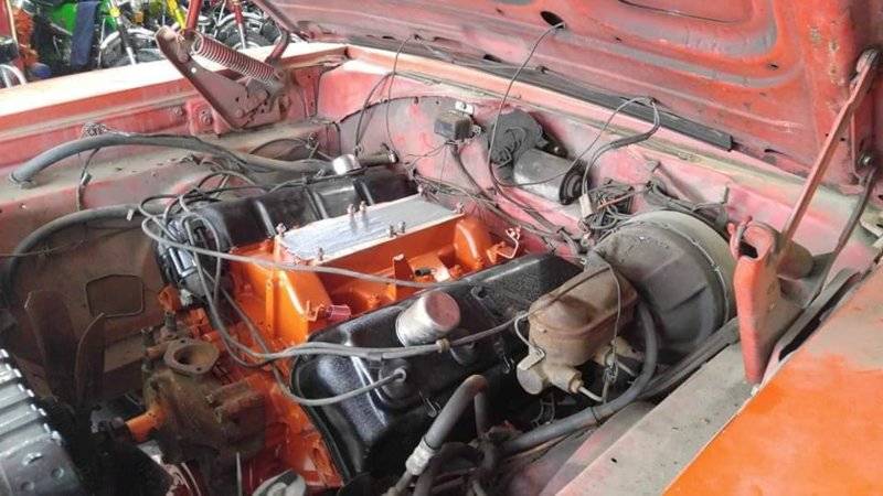

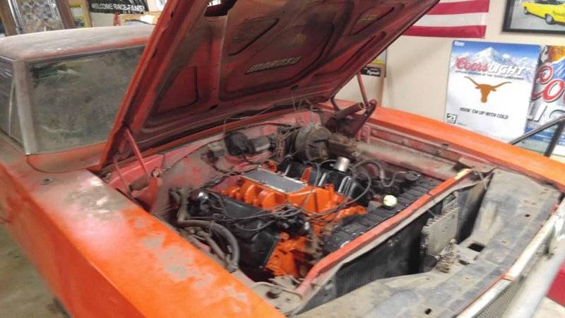

Seeing the valve covers are on the wrong sides & the crusty water pump housing, I would question the engine build because you just don't know who did what properly.
The reason I say this is that over the winter, I pulled the 440 out of my 68 Charger (you know the one I bought) due to an internal balance issue. When I pulled the engine apart, I found a weeping freeze plug, leaking valve seals, non-roller timing chain & gears, a hardware store bolt and washer holding the chain gear onto the camshaft & a hardware store washer under the harmonic balancer bolt. The balance shop I brought the rotating assembly to did find that it was out of balance enough to notice (so they knew I wasn't nuts). The engine was rebuilt by a professional shop, but you just never know. Two grand later & it runs like a charm, plus it doesn't leak anymore.
I would imagine that you're going to pull the engine out, so you might as well take it apart and take a look inside. The worst it will cost you is a gasket set.

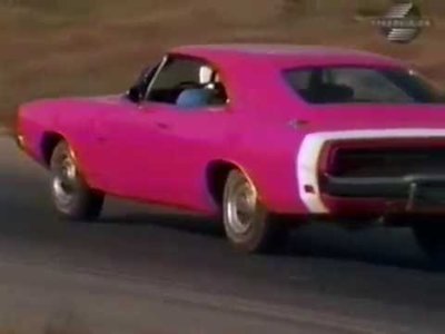

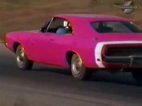

Nice looking 500....and it seems to be in pretty good condition.
I do doubt the claim about the car being the same as the one in the video...the one in this video seems to be Panther Pink FM3. Yours is clearly not, or ever has been that colour.
Looking forward to your build thread here. :)
kiwi, I think there's something off with the video. I remember seeing it before, and I remember it being a red car. I agree that it does look FM3 in the video above, but didn't that color first come out in '70?
Bud states in the video it's a Cherry Red Charger. Don't know if "Cherry" would be the right description but it's Red none the less.

I'll take some pictures of the carbs... Luckily those are correct except I need to get a proper top plate for the rear carb, it doesn't have the choke mechanism.....
