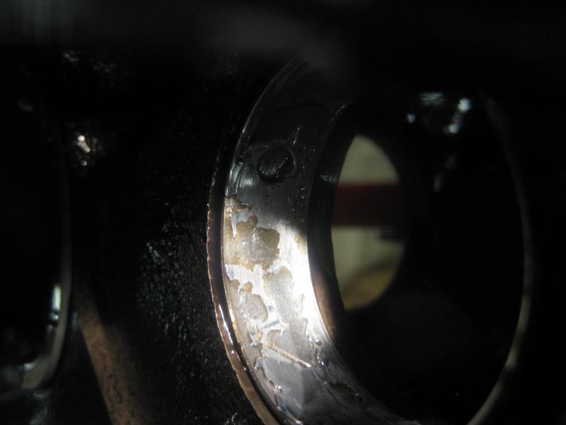

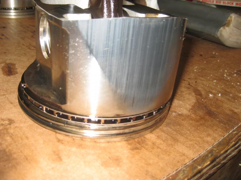

With just a quick look---How does the seller know it has adj. rockers w/o getting into the engine?? I'd pass.
For that money, I would pull a head and check the piston top for bored over size. If its 60 over of course this engine is done and walk away. You hope for standard bore or even 30 over is fine...guarantee its gonna need bored to the next size, with those bolt on parts, someone ran this thing hard, its gonna need machined
X2! This thing was raced. Is there any room for a rebuild, or is the block at the end of its life? Cylinder bore diameter would be a great check.
