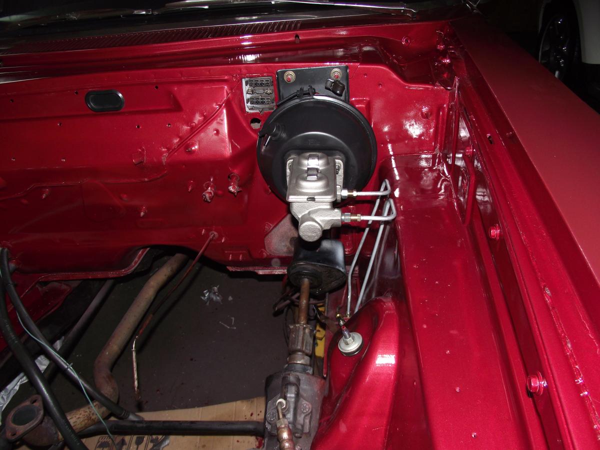

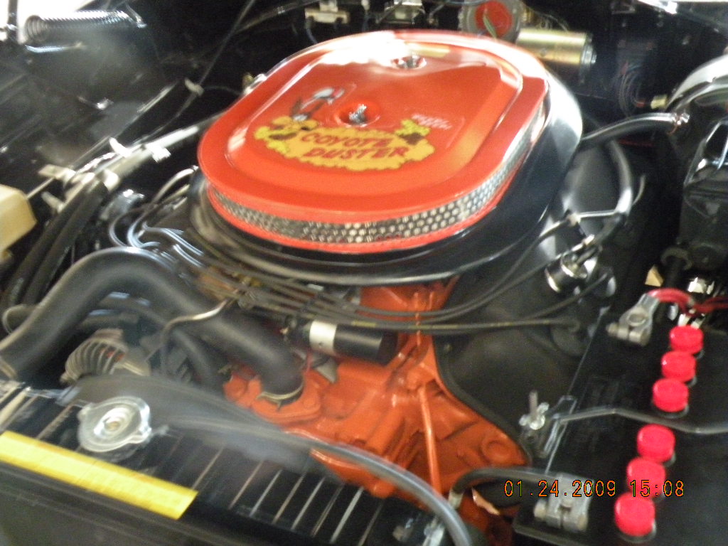

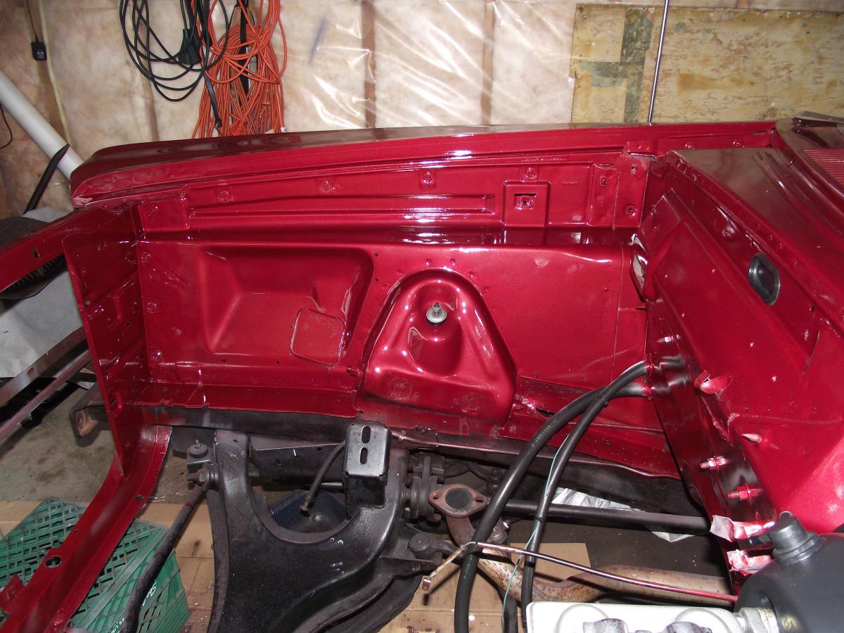

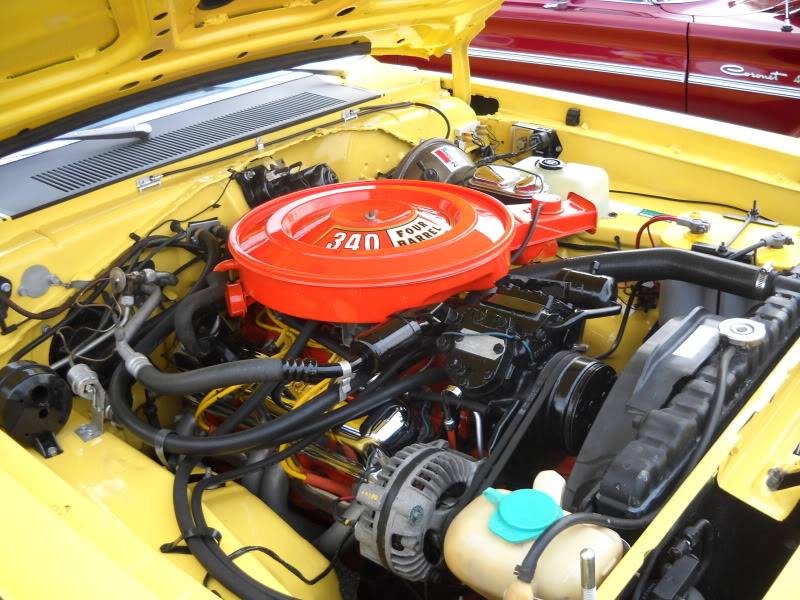

I did mine ,didnt use the rattle can ,I useed Neson paint and the hardner ,from the paint supply company.A little more money but worth it

Thank you for your replies, OK, the body colors in the engine compartment on the above jobs look great and that should be done as the body with two stage, but your brackets, master cylinders and black painted bolts etc are done with the same type paint? single stage urethane?
The brake booster ,was painted with a rattle can .It was from Eastwood ,called under the hood black which is pretty good paint.I have a friend in Coral Springs ,he moved there from Canada
