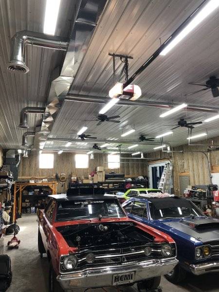

I keep forgetting what I have done. I also have 4 ceiling fans wired in on two separate controllers. They really move the air around and in my opinion make it fore efficient both heat and cooling wise. My shop is 36 x 42 12 foot walls with a 10 x 12 office. All with textured finished drywall.
Fans are a great idea to move cool & heated air around. Somehow, i forgot about all that!
With my vaulted ceilings, i'm thinking maybe rotating fans @ the tops of the walls 10' high or so? I'll dig into that a little more.
You most likely can put them at the peak. There are so many different drops and width. As long as the blades do not hit the ceiling you should be good. In my shop it makes such a difference that I know right away when one set might be off by accident.
