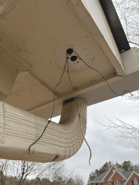

I was doing a side job yesterday. A lady was complaining about her flood lights not working. Well, either squirrels or mice got to the wiring.. Notice the wire being bare all 3 strands up into the soffit. This house was built in the 90's so not so sure soy wiring is the culprit. I think they just like eating whatever is around them.
