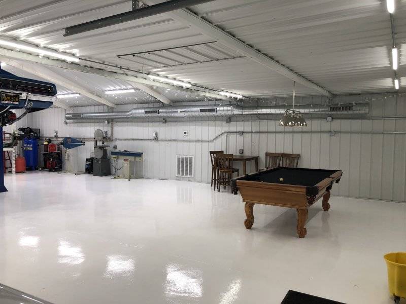

You might consider interior weight white steel for the ceiling finish. It really helps reflect the light.

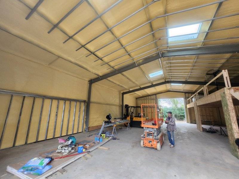

I chose a 12,000 mini to just dehumidify the air. The shop rarely gets warmer than 72*. The conditioned space is about 35'x68'x10' or 23,800 cu ft. The North-South building is 144' long. The East-West building is 78' long now that I added a full width lean to on the East end (not shown). I probably use the mini for maybe 2 weeks per year but, it seems to get longer each year as it gets warmer each summer.

spray foam 100% 1.50 sq ft, for 1" around here will pay for itself.

I like the closed cell spray foam. I have an exterior mounted heat a/c unit and keep it at 70 year round. Works awesome.

Oh boy, this is killing me!! That floor....that floor.....it's bootiful!!! How did you do that?? THAT will be my final chore to complete BEFORE my cars can come in. Love it! Scott
Haha, thanks. I ground the entire floor with a diamabrush and angle grinder. The material was from Legacy.
Off white primer. "super hide white" Epoxy and then "super hide white" urethane.
Gorgeous! I see that beautiful charger up in the air, too. I've been following all you've been doing on it. The love for that car is clear!!!

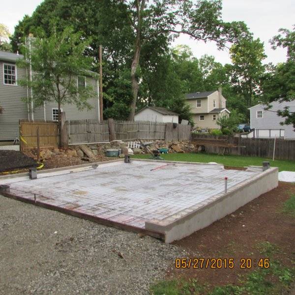

SLAB insulation is important I put 2 layers 6 mil poly 1 on dirt 2 over stone grade and 2"x16"x8' rigid poly laid around the perimeter
