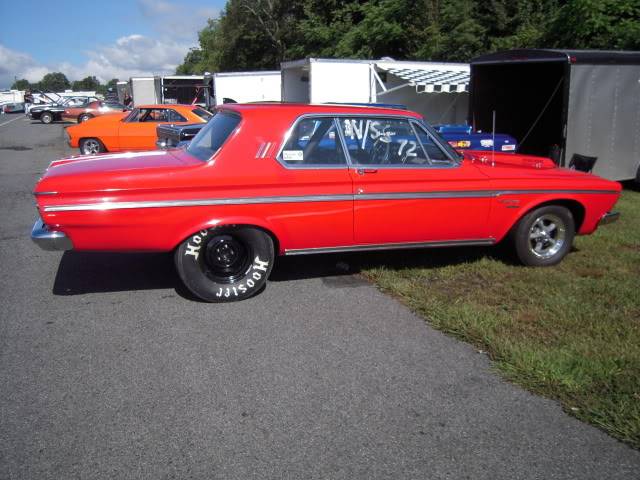

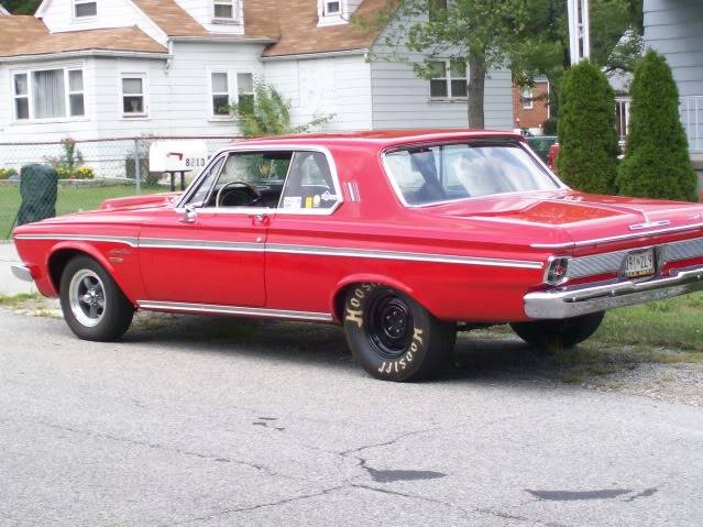

I run Hoosier 30 x 9 radial slick. I have actually been driving on the street with them for over a year. The letters stayed pretty clean. And mine hold air great without tubes. They held all winter without leaking down any. Ron

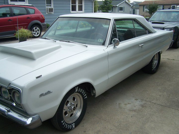

I think I need the same size on my 67 as you have.
I put the 11.5 Hoosiers on my car only to find they're just too wide! Does your slick have the two grooves "tread" cut around the entire tire "DOT"?
Thanks...

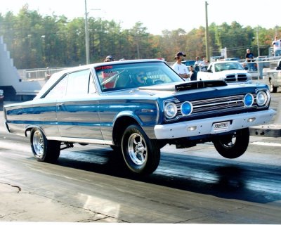

FWIW- if the front of your wheelwell isn't cut you won't fit the 9 x 30 tire.
I have completely stock openings and the M/T 9 x 28 slick or the M/T ET Street 11.50 x 28- with the grooves (DOT approved) fit and work perfectly on my 67 Belvedere.

My wheelwell's are stock as they have never been cut. I did install a 65 B-body rear but thars all. I am using the 30 x 9 slicks with no tread groves. I wanted a drag radial with two groves but no one makes a drag radial in the 30 x 9 size which is what I like to run so for now I use the slicks. Ron
