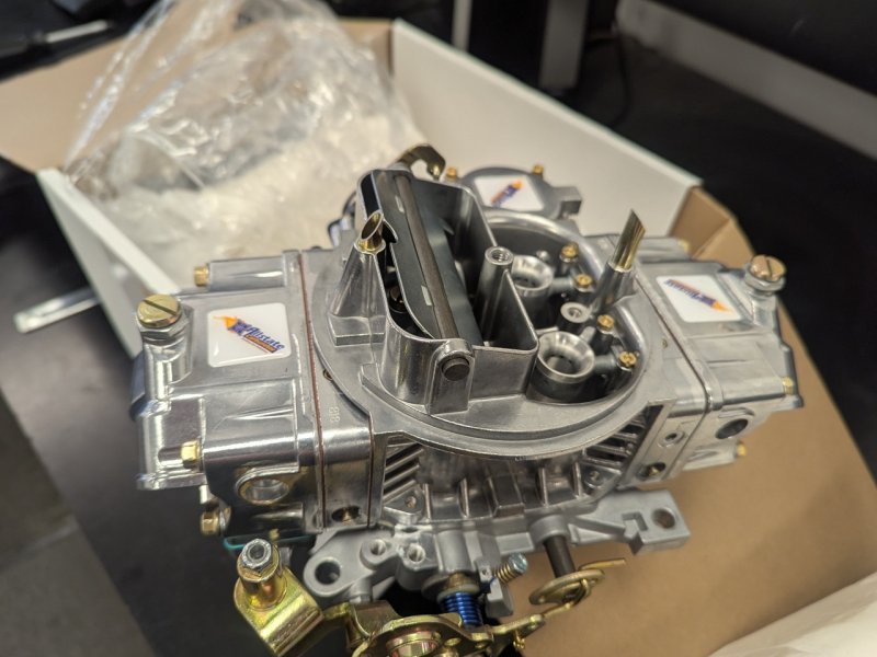

Shiny new carb day.. went with Annular boosters.. and vacuum secondaries cause of reasons... I like the new VS's you don't have to change a spring to adjust the secondaries.. makes it soo much nicer..
Also has the jets behind the power valve to adjust how much it lets in..
Grabbed it from allstate carb.
Now i need to get a fuel line for it..
