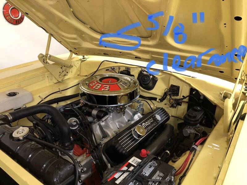

I have this set up but in a B motor which has 3/4” less deck height than the 440. I can use the stock Mopar performance unsilenced air cleaner & base, which in not a drop base in design, and also have to use a 2.25” tall filter in order to give the air cleaner enough hood clearance. This combo gives me 5/8” clearance at the tightest spot which is at the back of the hood where the curved cut is part of the design. The filter is a wix, don’t have the part number but if you look up a common Mercedes air filter that is the one. 13” x 2.25”. The stock filter height is 2.75” for your reference.
So: 440 engine is 3/4” taller than mine, and the drop base air cleaner will drop it about an inch, therefore those two elements cancel each out. Then you are left in a similar scenario to me. You will need to source a 13” drop base, I think Mancini has them if not pro-form makes them for Ford applications but you’ll have to buy the whole air cleaner and toss out the lid.

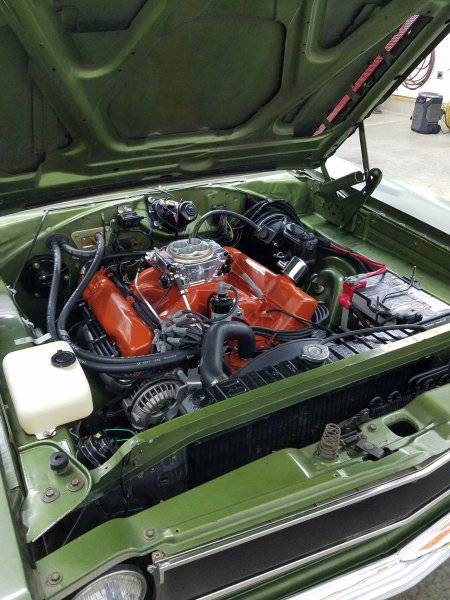

1969 GTX 440 based 505ci stroker with the Performer RPM intake and Holly Sniper EFI using the Mancini drop base and stock air filter. No problem fitting under the stock hood.
